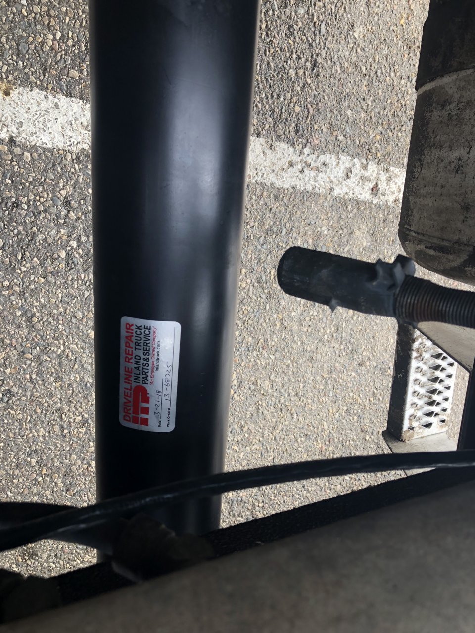

    Yes I’ve had 2 dealers to check ride height in specs 2 yokes has been replaced new joints as well. Had new drive line replaced the 2nd one from transmission. New u joints on the drive line between the rears also read tired are balanced too.
