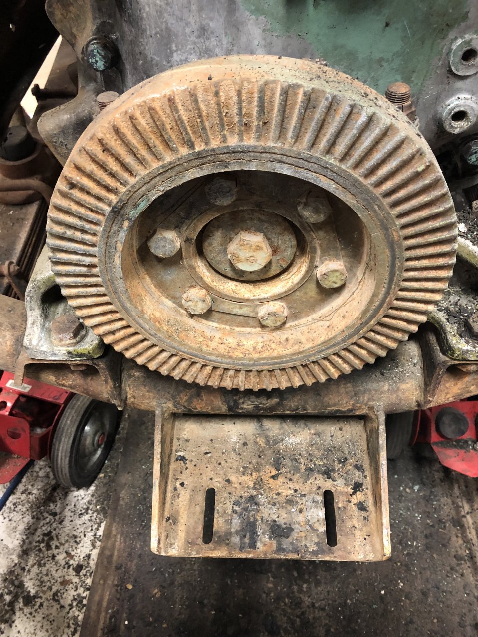

    Tapered snout crank will look like this. Big center bolt holds on pulley. Two piece rubber insulated damper bolts too that. Just like a traditional crank in a car engine. As far as i know there is no viscous damper made for these old ones.

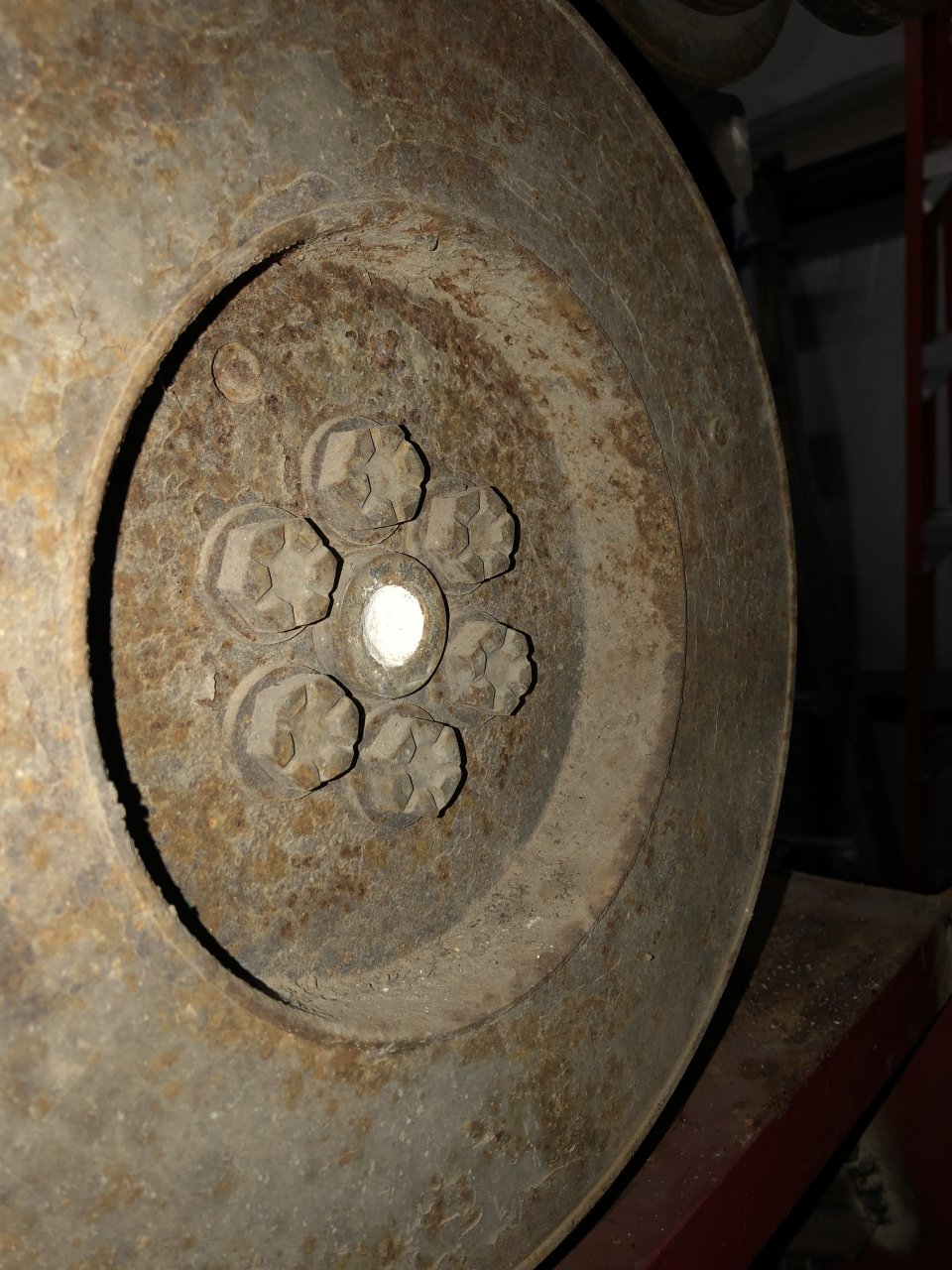

    flat snout crank. No center bolt smaller dia. Bolt pattern and viscous damper still available from original supplier.

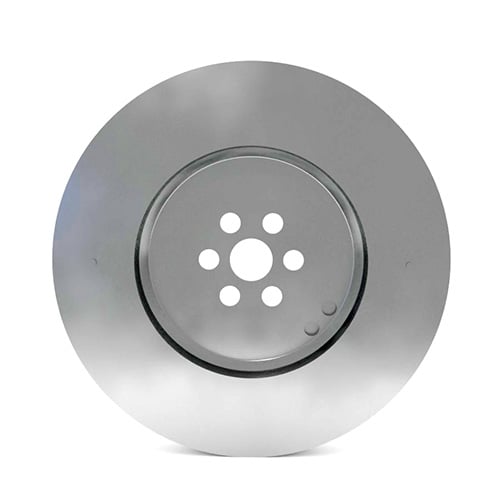

    I found this on vibratec and says it replaces damper on small cam
    ENGINE MODEL
    NTC290-350 / 855
    Reference Number 211915
    Part Number 715285-000
    O.D./Inches 12.3
    Wt./Lbs. 34
    jldilley Thanks this.

    yes just talked to tech dept at vibratech and they say they do have the damper for our small cam
    ENGINE MODEL
    NTC290-350 / 855
    O.D./Inches 12.3
    Wt./Lbs. 34
    and this to be the correct one now I need to contact their store for where I live thanks again for your help greatly appreciated and nice to know there's still good people out here cause the cummins group on fb are ########

    Thats awesome on the tapered crank one. That must be a rather recent development. I know Cummins has a group of historians and techs that have been working on the sidelines restoring any old Cummins model engines they can find that have historical value. So maybe they got that deal working. Vibratech has been Cummins oe damper supplier since the 1950’s when there name used to be Hydraulics Houdaille.

    Yes. That is the right damper for any small cam or big cam with the flat snout crank. They have always been availiable. But like I mentioned make sure yours is not tapered before you order it. Most small cam 290’s were tapered up until around 1974. All The big cam 290’s were flat. The first flat crank small cam was the cpl 160 350. It was also the first aftercooled large production number engine offered.
