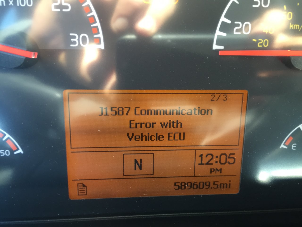

Please somebody can help me ?? -->> J1587 Communication Error With Vehicle ECU

    it could be the ground on the frame as well :/ good luck driver

    Hey,
    yes sir finally everything's ok now,you was right :)
    it was wiring's problems,corroded and some connections from that place what you told me before :)
    --->>> " [​IMG] Originally Posted by bravoo67 [​IMG]
    also you could check the plug with a looooot of cables in it on the wall in engine compartmen right by the foot breake valve with green and red air hoses..drivers side ofcourse there is a screw holding it in place but you never know :icon_smile:
    or it coudl simply be your ignition switch.. one you turn the key in
    and Thank very much for your help !
    Here is the Reports from Dealer :
    Cause : Found no power at fuse 71 and 72.
    Correction: 705-M674841- Installed driveline and check codes- has no communication with VECU.
    Found no power at fuse 71 and 72. Troubleshoot power 17A. Followed wire back and found corroded wire at 14 pin connection.
    Remove 17A from connection. Clean conn and install new male and female end.
    Confirm power- OK.
    Resecure harness and clear all codes. Check operation - All OK.
    That's it :)
    Sincerely !

    I have the same issue. 2008 Volvo Vnl430 just would not start. Pulled all the relay switches it started then went into the j1587 error unable to communicate. Checked the fuse and unhooked the battery's. No luck.

    make sure there is power coming to the vehicle ecu, check to make sure you have proper power at all fuses

    Did your truck come.with a battery cutoff switch? I have had the same issue that you describe but it would always go away months on end. I finally replaced the cutoff switch and made a world of difference on my electical gremlins.
