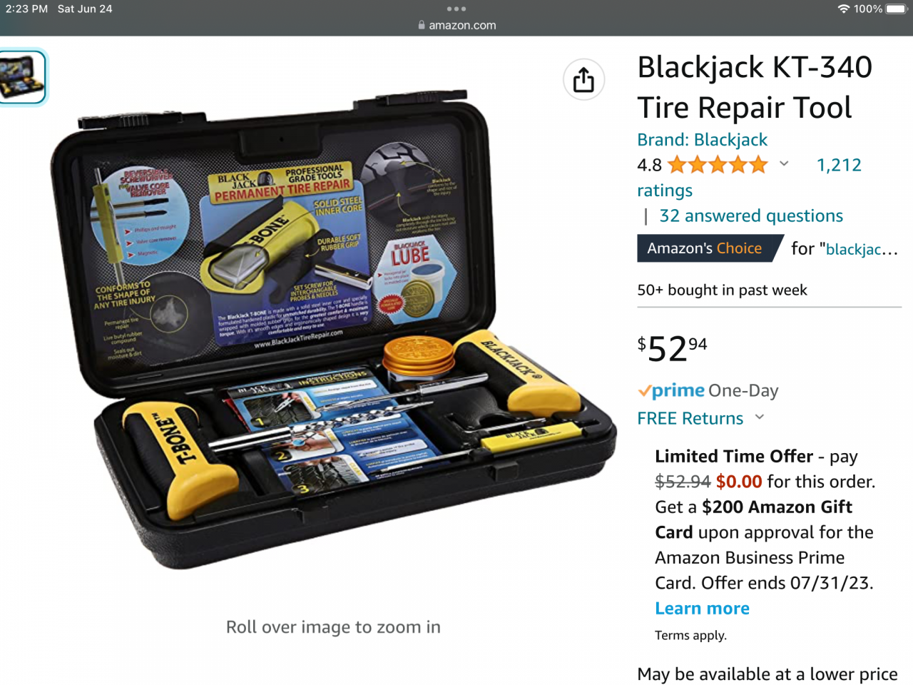

    I got this plug kit after the mechanic where I park plugged a brand new trailer tire for me with his. He said it was only temporary to get me to a tire shop. I would occasionally spray it with soapy water and no leaks. I ran it several hundred thousand miles before I got new tires with it still in. I have never met a tire guy that likes plugs from the outside of the tire. I have found that if you drill a pilot hole with a 3/16 drill but it makes it much easier getting the auger and then plug in. D107F3A1-0D27-4DF5-B72F-4C7D791D792B.png

    That tire kit kicks A over them cheaper kits you can buy anywhere. And are lucky to get one job out of them.
