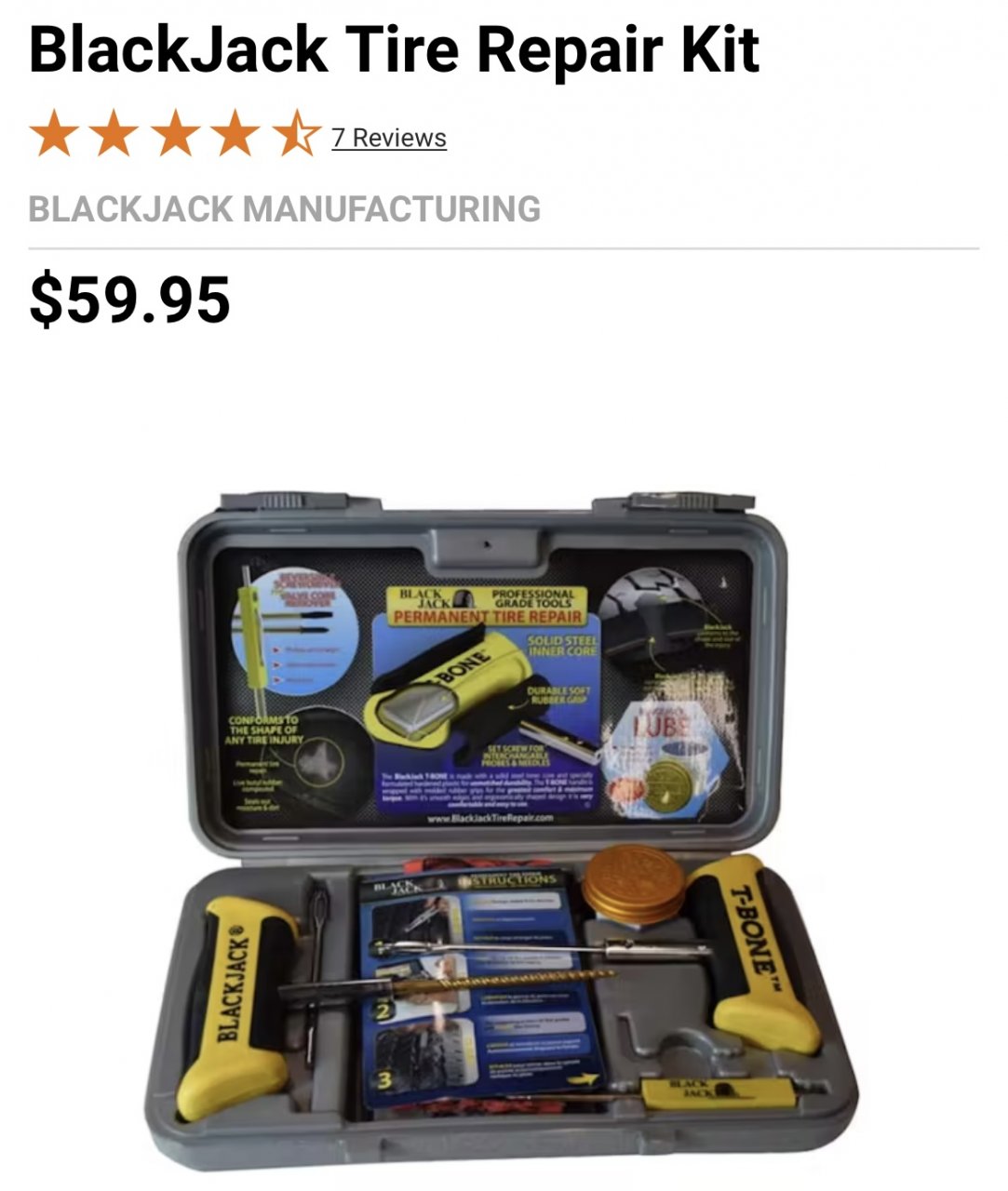

    This is what I carried when I hauled cattle and then got another one when I was pulling my hopper. I never had any issues with the plugs holding. The only time I’d have a tire broken down was if I pulled out something long or if it was close to the sidewall, I wanted to make sure nothing rubbed and wouldn’t have a failure later on. If it was in the center of the tread I would just keep running it. A lot of the cheaper kits don’t look like the tool is long enough to get clean through to the inside of a truck tire and they probably don’t ream the puncture out good enough.

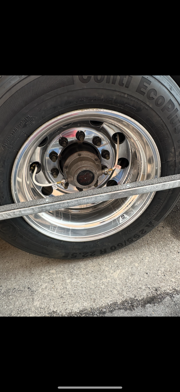

    This is the same kit I carry along with a cordless drill and 3/16 drill bit to run a pilot hole before I use the auger. I don’t plug anything larger than a nail but I have plugs that lasted 200,000 miles. I actively watch every plug I have done and if there is any sign of air leaking they get repaired at a tire shop. I will not be stranded on the side of the road waiting for road service to put my spare on for $600 when I can plug one and get myself down the road safely. Tire repair folks may get offended by this comment, but I have met very few tire workers that left my tire/wheel/auto inflation system hose or anything related in as good of condition as they found it. Therefore the less people handling my tires, the safer my rig is going to be. I didn’t catch this wheel until I was on the tire shop ramp because they wouldn’t let me in the bay, but you can bet I made them take it off and rotate the wheel one hole position to get the hose out of a bind which would eventually fail. IMG_3752.png
