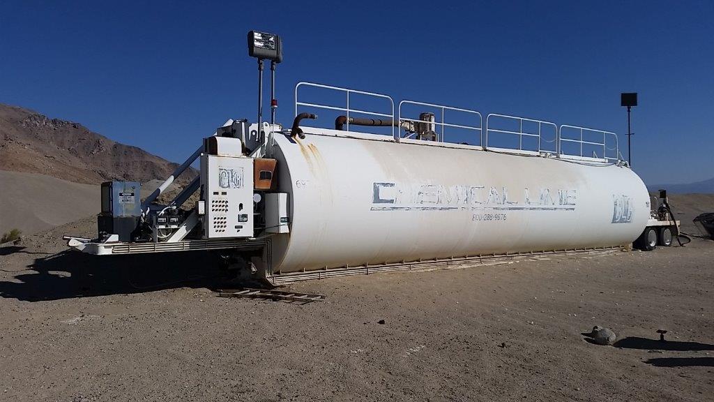

    @tscottme mentioned slurries. All the slurries I've ever seen, lime slurries, have been pulled in liquid tankers with spreader bars attached to the rear for spreading the slurry onto the ground. But I have hauled plenty of crushed lime in a pneumatic and unloaded it into a slaker located at the job site so that they could mix it with water to make slurry.
    A slaker is a large tank where lime and water and mixed to produce a slurry, which is then pumped into a truck that spreads the slurry on the soil:
    http://www.asiequipmentsales.com/img/products/44/img_61.jpg
