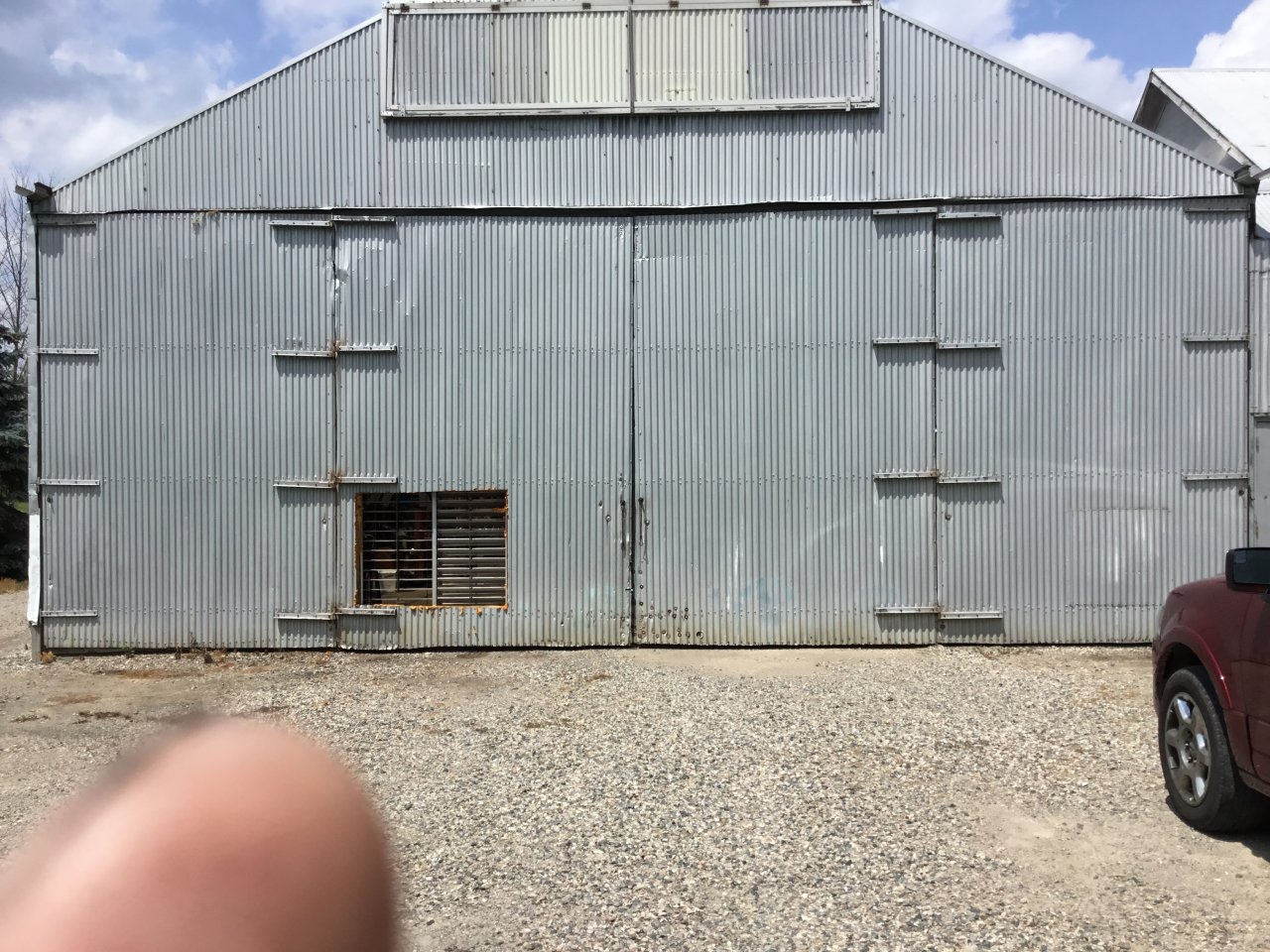

    My pole barn in previous post it’s a greenhouse structure cheapest building you can put up (dollars per square foot) some jurisdictions it’s also a big tax advantage.
