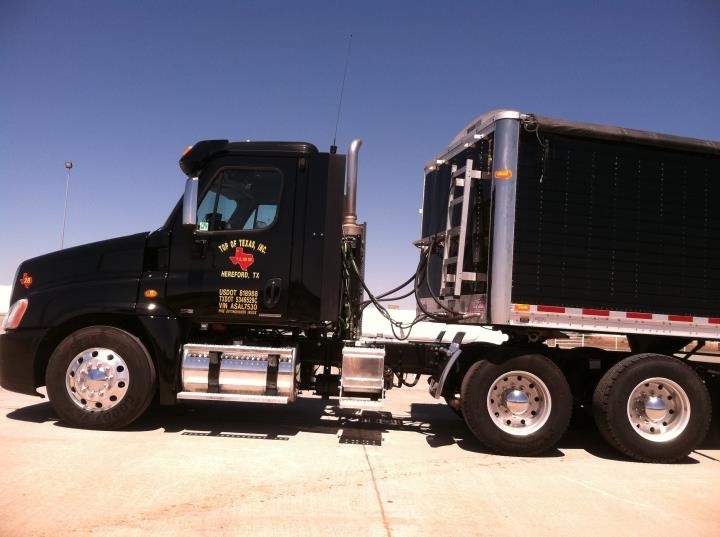

    Im no professional. Both times I polished my tanks I didn't sand them and it turn out looking good. Ill try to find pics of my old tanks and show ya. They were in bad shape when I polished them.

  10. Trucker79010
    Trucker79010 Light Load Member
    150
    22
    Jun 16, 2012
    Valle De Oro, Texas
    image.jpg That was with no sanding.
