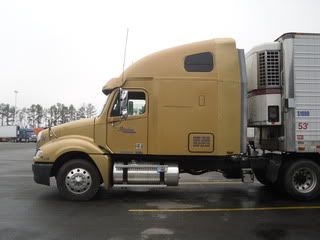

    I am driving a 05' Columbia thats a former Trans Am truck. The mileage sucks. The best I have gotten was 5.8mpg grossing out at 77,800. The best dead head was 7.0mpg. The truck spec's are:
    2005 Freightliner Columbia
    515HP Detroit 14.0L
    10 spd ultrashift two pedal
    3.58 rears
    22.5 rubber
    Heres the truck:
    Can anyone please give me advice on how to get better fuel mileage. The oil used is rotella. Also the tires were recently changed to all new virgins.
