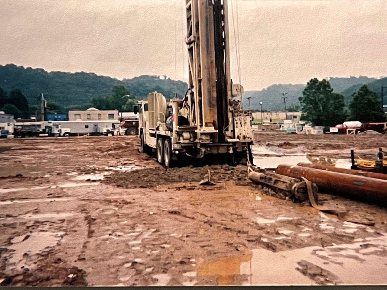

    This Ingersoll Rand T-4 drill had a 600hp Cummins up on the deck. It had a similar setup but it used gasoline to fire it. Basically a steam Jenny setup that circulated the coolant as it heated it. Below freezing it would warm the block in about 30 minutes….
