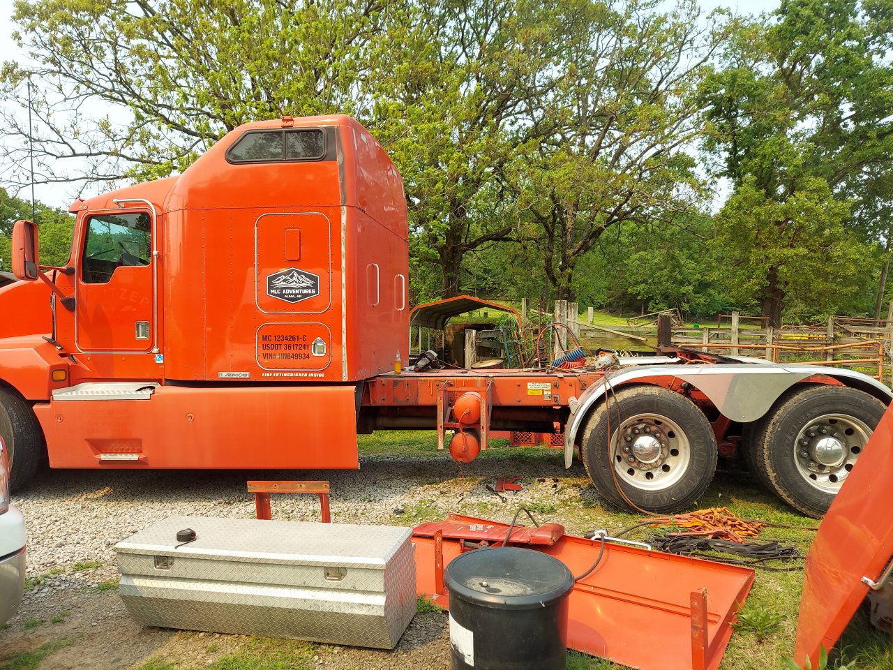

    I'd guess that's no more than 230wb. Measure from front axle to center of the drives. Not the rear hub but actual center of drives and there's your wb

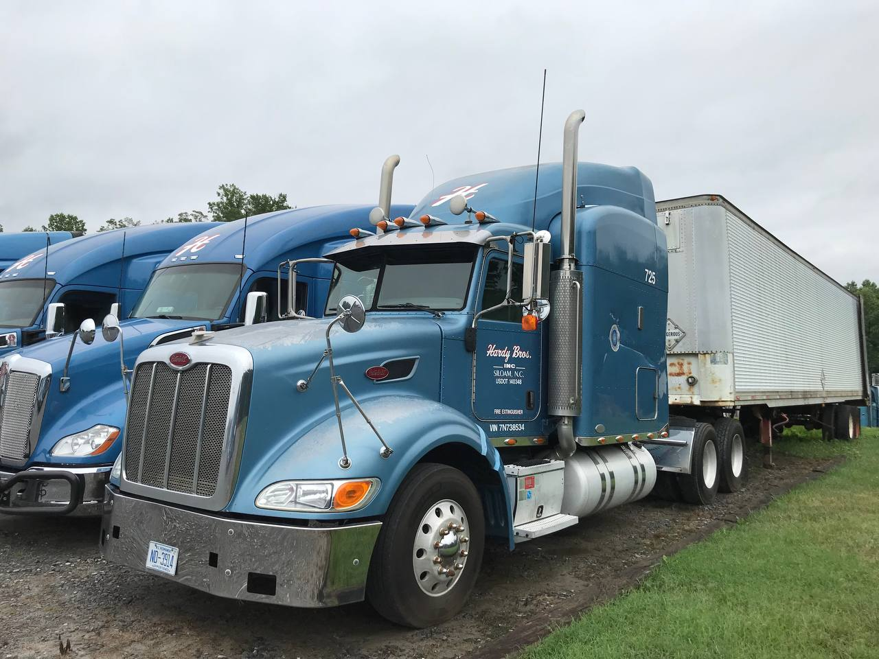

    Are you saying those trucks don’t have air ride rears? I haven’t seen a class 8 Pete built in the last 20 years with Rayco type spring suspension unless it was a heavy spec Hendrickson walking beam. Ain’t no refer company gonna run that.
