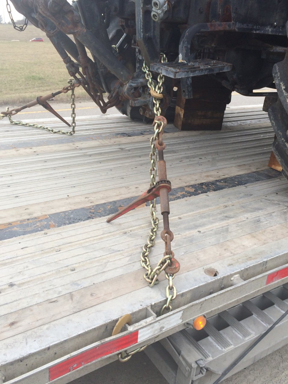

    Only 3 points of contact on rear chain/stake pockets...tssk, tssk!! IMG_0400.JPG

  7. DDlighttruck
    DDlighttruck Road Train Member
    1,386
    19,919
    Dec 12, 2015
    What'd I do wrong now? I know what you're pointing out but I didn't know it was a regulation to follow.
  8. PeteyFixAll
    PeteyFixAll Medium Load Member
    373
    8,071
    Oct 26, 2015
    DD It's not a regulation.
    The way you did it is my preferred method.
    That hook will stay hooked to the trailer even if the chain slacks for some reason.
    Problem is not all manufacturers stake pockets are equal! some aren't rated to be hooked that way.

    And, or is that chain pot near your binder hook?
    Short chains are the way to go! right.. Not left wondering what to do with the other ten feet of chain!

  10. DDlighttruck
    1,386
    19,919
    Dec 12, 2015
    Yes there's quite a few chain pulls. I was trying to go back more instead of more of a side pull. If that makes sense
  11. GOV'T_Trucker
    GOV'T_Trucker Heavy Load Member
    782
    668
    May 28, 2011
    I would prefer to bring the chain in-front of the stake pocket around the stake pocket and back up. That way the chain is against the stake pocket all the away around it.. So basically your hook will be on the other side of the pocket compare to what you have. Or hook the hook back on the chain.
    Not that there is anything wrong with the way you have done it...
