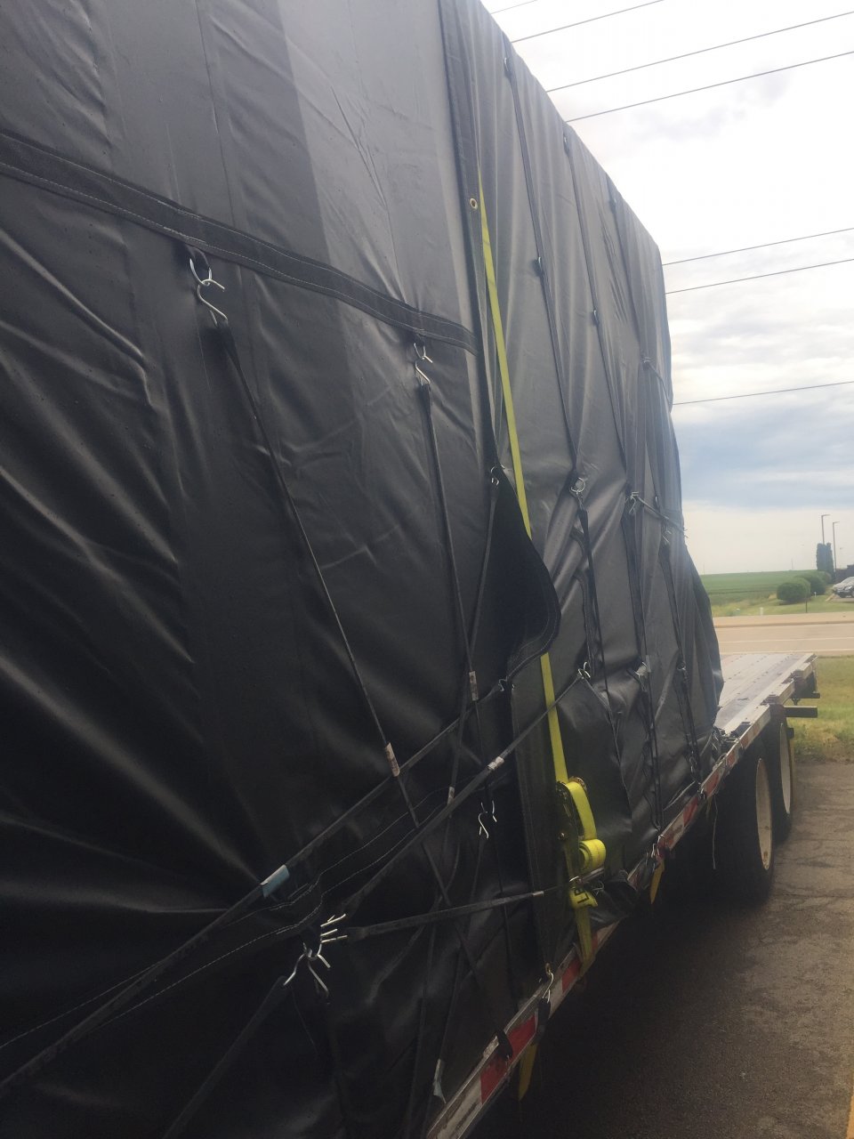

    Do you have either strap corner protectors or chain steel corner protectors?
    If it was me I'da had two chains on an X on the stacks on the step. Then chains w/protectors on the top piece, if running out of chains then straps w/protectors on the rest of it. Looks like you were more than legal for straps, but that way it's piece of mind it's not coming at me.
    Legal and life preservation are two different things

    I do have corner / edge protectors. I will be Xing the next time I haul. I used all but one of my straps. Then used it after the whoa...

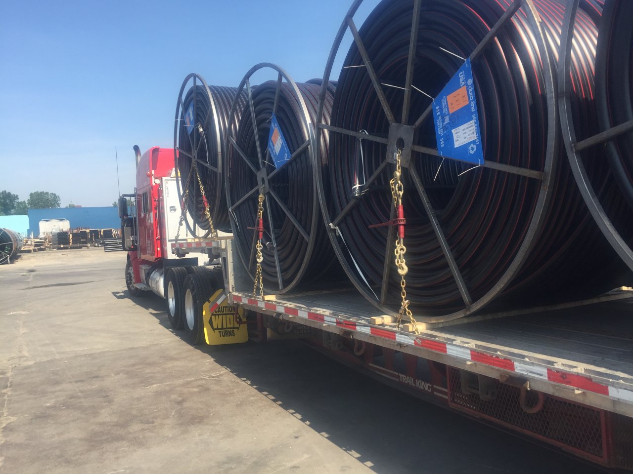

    I delivered a few of those reels last week, just rolled them off the trailer. :laughing6:
    cke, Razororange and passingthru69 Thank this.

    Not to start an argument but straps are perfectly fine on steel, assuming they are used correctly. Many shippers don't want a chain anywhere near their product (welded tube for instance, especially galvanized or stainless). For me (as a result of company training) you take the FMCSR minimum, double it, then add 2-3.
    Full coverage at the very least on aggregate working load limit. That way, if some do "give way" there are plenty of others there to back them up. But further, this also relies on the driver actually doing load checks every 150 miles and making sure they stay tight.
    Emergency stops with steel, no matter how much securement you put on there, can go south very quickly.

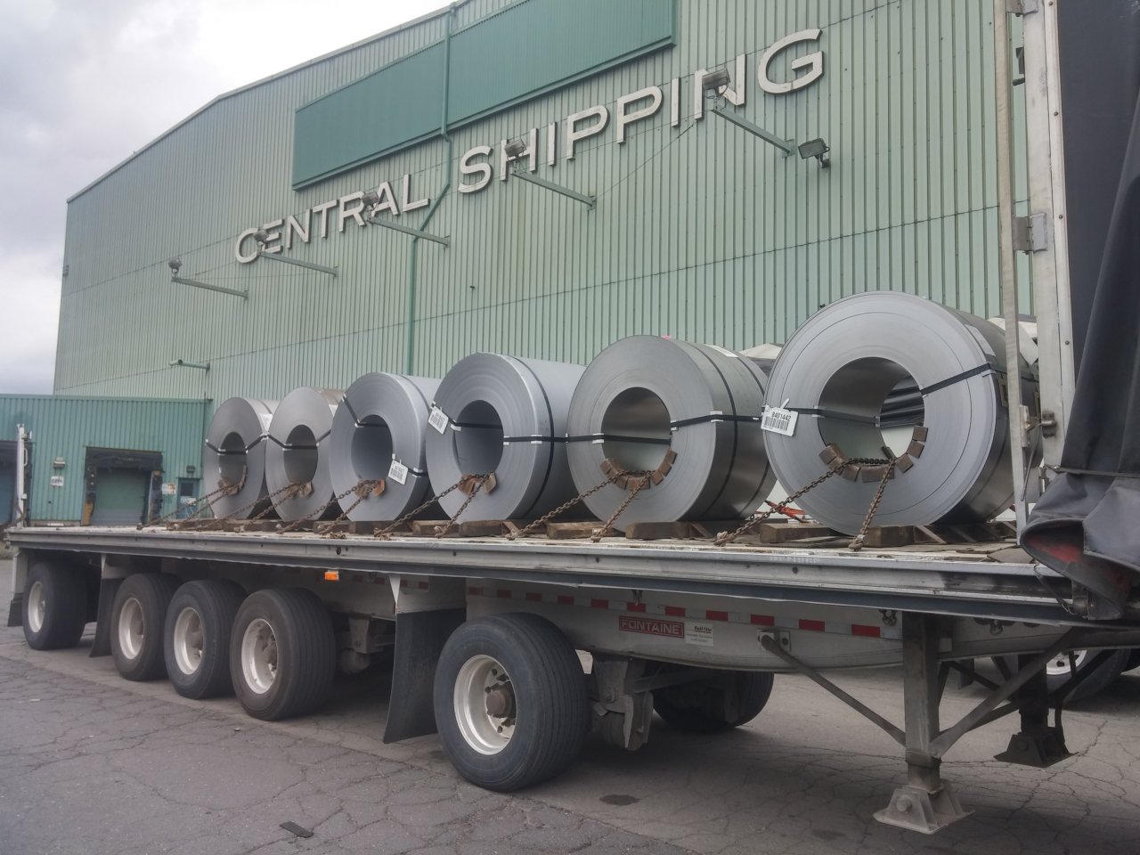

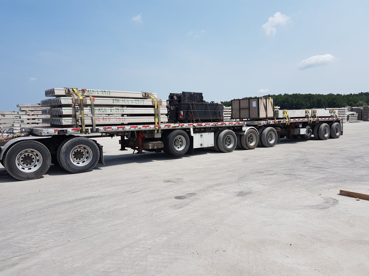

    My dispatcher is such s a comedian some days. I just love loading inside a 100 degree steel mill for 2 plus hours 20170724_150322_HDR.jpg
    6rider, 1951 ford, Lepton1 and 15 others Thank this.
    Hadn't seen that before. Usually they're 3x3, had to use two straps on each. It's been so long since I've done them can't remember if I did use two on each skid usually.

    That looks familiar. Look on the bright side, you didn't have to cover each coil individually with plastic and then tarp it when you got outside.
  11. special-k
    special-k Road Train Member
    1,523
    3,258
    Dec 27, 2008
    Southern Ontario Canada
    Ya thats definitely the nice thing about a slider. No tripping over chains pulling your tarp over lol.
