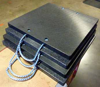

    Where do you get those and what are the dimensions?

    They look like crane outrigger pads

    ^^^^ What he said. They're outrigger pads and you can get them in any size you want even round.

    i have carried 5 of these since 2010
    Super Dolly Pads, Trailer Pads, RV Pads
    these are 15"x17"x1" and weigh 6#
    they will support 50,000# each as dolly pads
    if more than legal weight on the drives I would
    use 2 per side with 2 24" oak 4x4 blocks to bridge them.
    they are made in Canada so if you can try to have a Canuck pick up some for you (or you can try to buy some from a Canadian company driver if you see them strapped to his deckplate)
