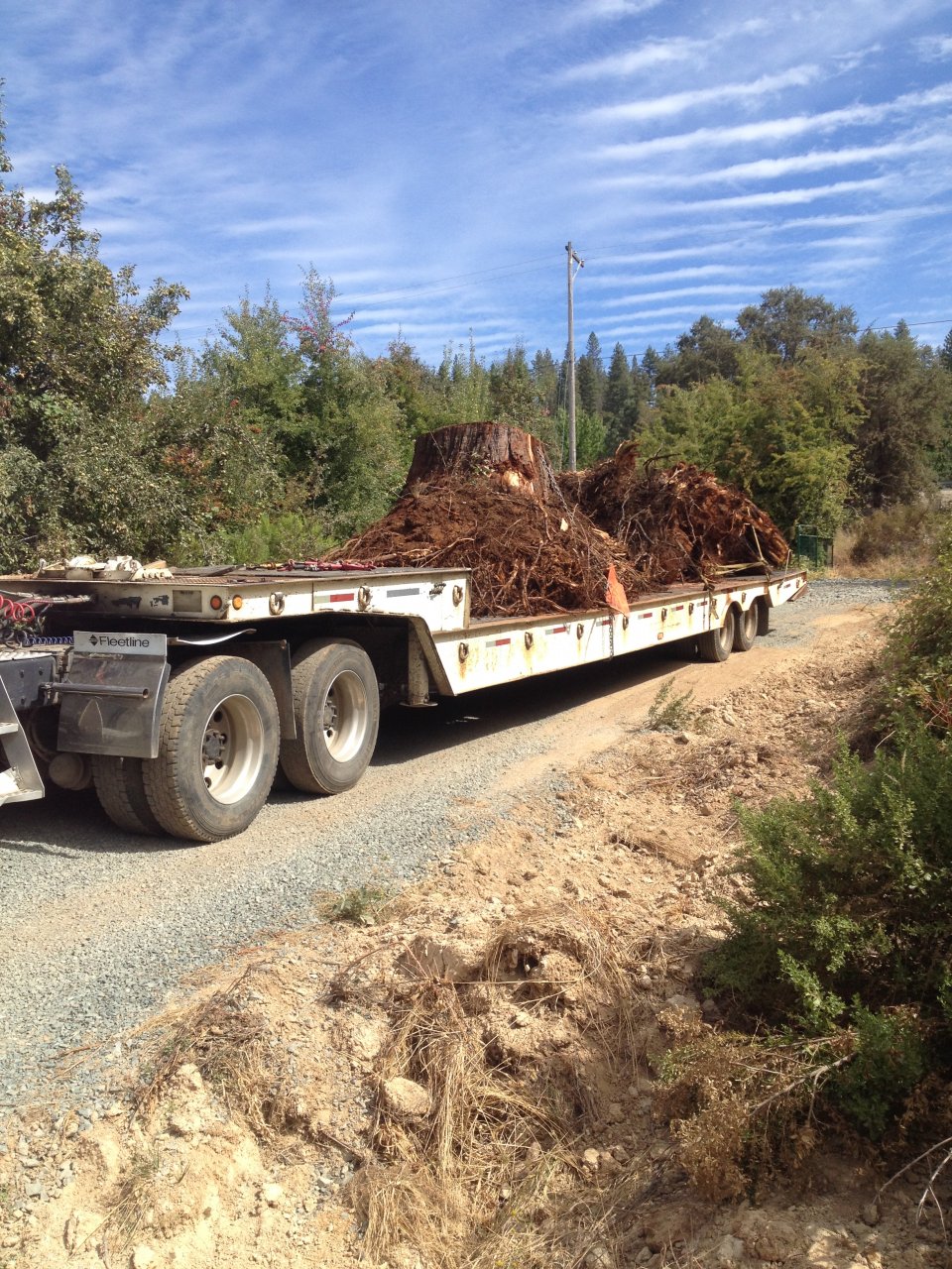

    image.jpeg And then we have this.....

    Free drain hole with minimal effort

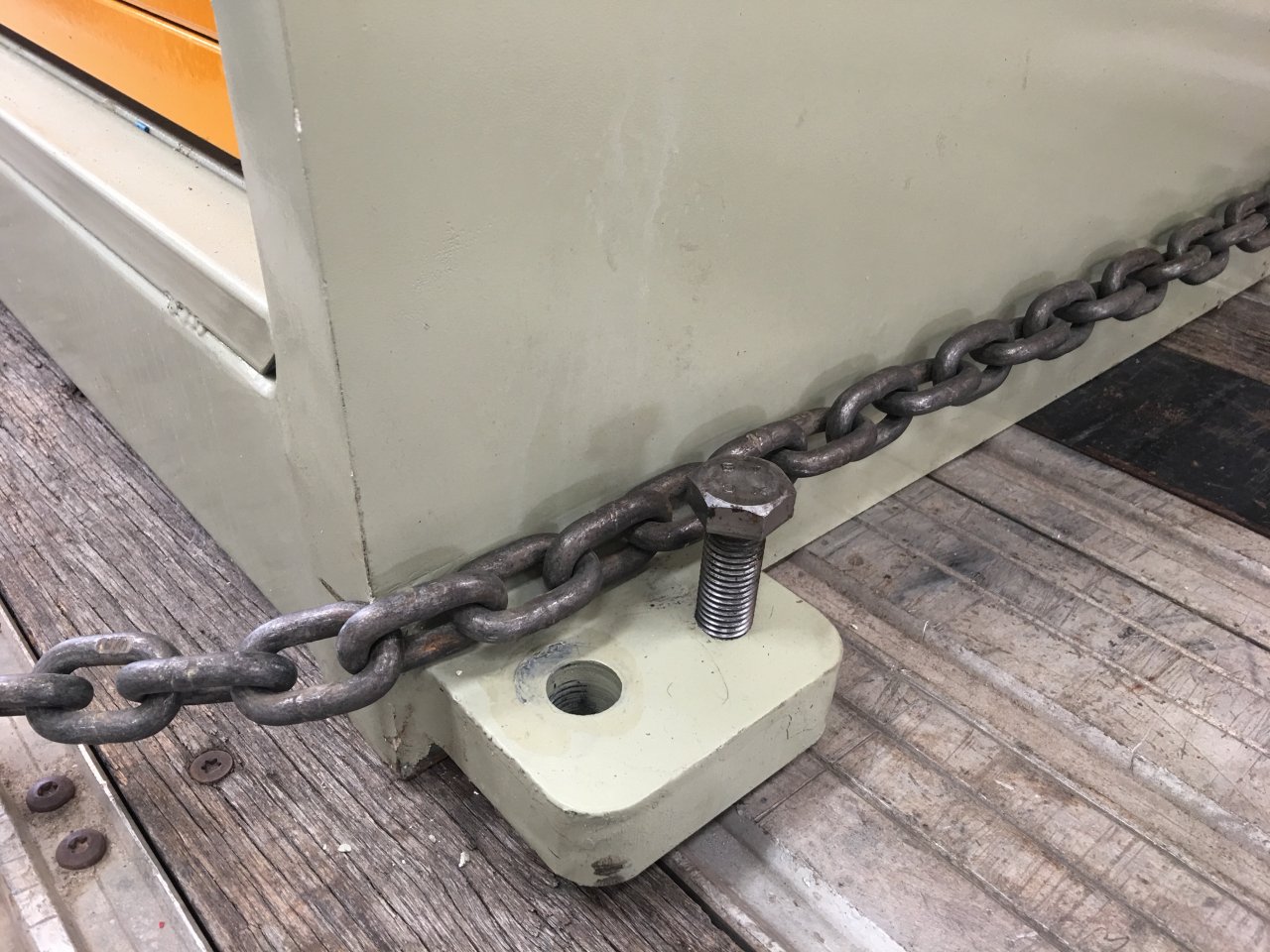

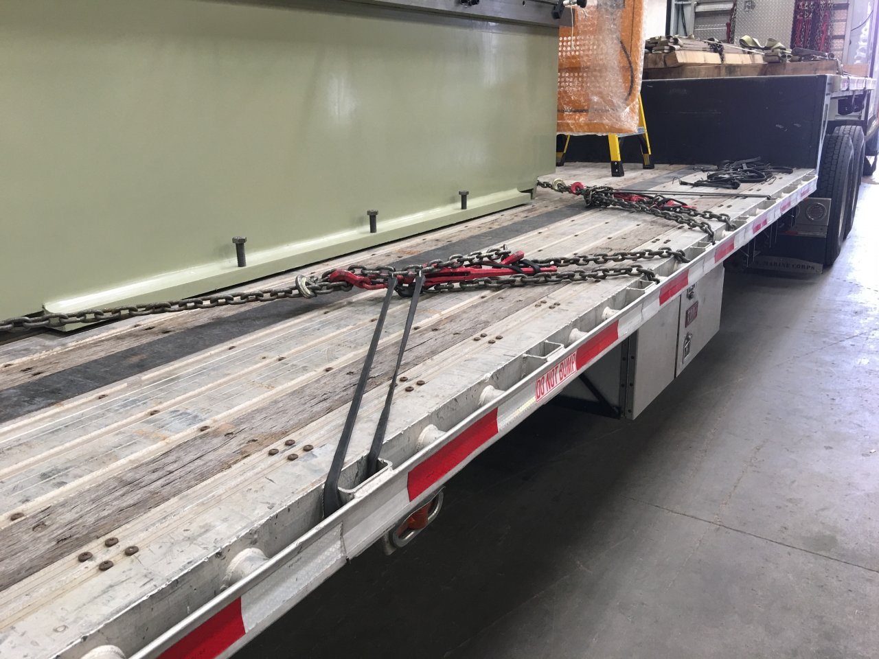

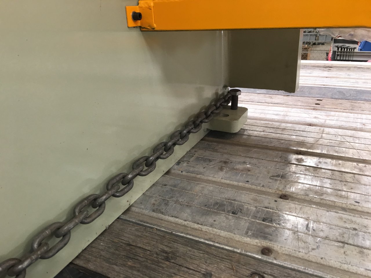

    Does this work? Its a brake press machine, 18,000lbs. Wouldnt allow straps to go over it. Used two chains pulling opposite directions at 45 degrees...

    Pressbrakes are top heavy, can't see the sides but, usually there are lift points.

    No way in hell I would run it like that. How much down force does a strap straight across the deck give you? Zero. You can't keep anything under them. Same with a chain. At that angle there's no strength.

    Well, each of those chains are functioning to hold the unit from moving either backward or forward, but only one each. So it's really not terribly secure. There's little keeping it from tipping as it goes around corners, and hardly enough to keep it from sliding forward in braking situations.

    Ok so how would you guys do it?

    I’m thinking they picked it from the top somehow. Wish there was a top picture
