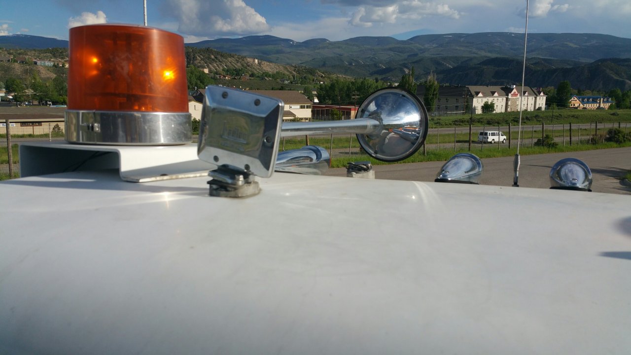

    tomorrow will be 3 weeks
    for a broken horn mount!!!!!!!!!!!!!!
