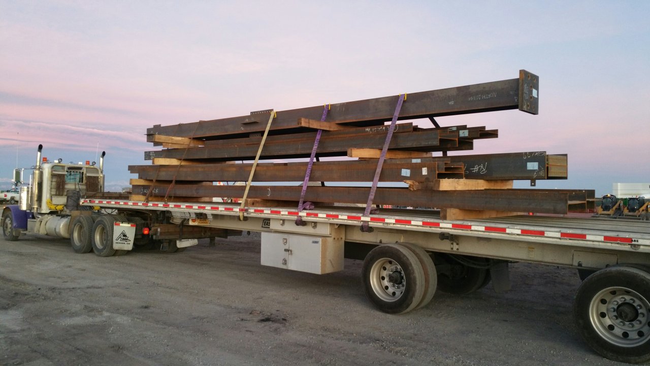

    @old iron questioned this pic. He states it legal. But loads over 3tiers high and 6 ft tall require belly straps. And belly straps do not count as main securement that’s required to cover for length.
    Because he stated it was legal, I was just suggesting that he go back and review the regs.

    I just reviewed the FMCSA driver's handbook for cargo securement and the only thing I can find about "3 tiers/ 6 ft high" is specifically describing dressed lumber, plywood, drywall or other engineered building products of similar shape...could structural steel fall under the category of "engineered building product"? I guess it could if you end up under the scrutiny of an overzealous LEO...
    I'm gonna call this a grey area. You guys running 48 states probably have to deal with a bigger variety of LEO's than I do just running regional...but 33 years of hauling structural and I can't recall being hassled for not having my lower tiers tied down.
    The handbook does mention immobilizing movement of cargo by using other cargo, which one could interpret as using the weight of other tiers stacked on top of another tier...

    @TripleSix is correct, I was wrong, It needs an intermediate strap.

    To my knowledge that is only required on dressed lumber or similar building products. Still a good idea on these structural loads. Especially when they are blocked well apart like that.
