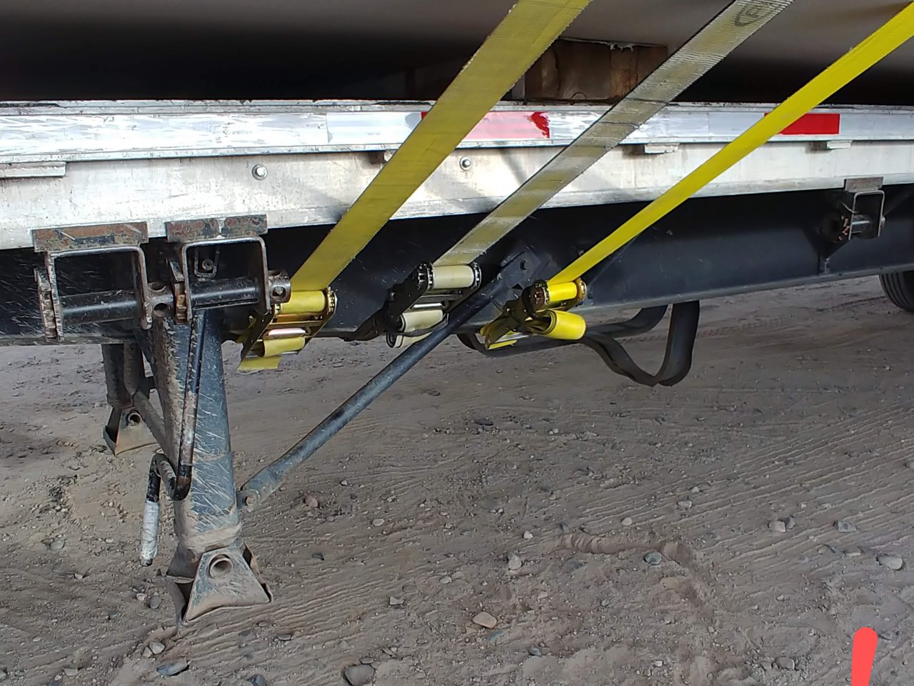

    For illustrative purposes, this is what i prefer on wide loads. "Most" aluminum trailers were not designed to be pulled outwardly, whether by winch or chain.
    So i go to the frame with edge protection where necassary. Which the above is what @LoneCowboy was describing i think.
    If you absolutly need to use chains, many of the other suggestions might be your best option option.
    Since alot of aluminum frame rails are too thick to get your average chain hooked too. A few of the ones we had we either used pullouts on chains or had a few trailers with hook points added underneath.
    Could use a 4 inch strap with J hook and chain hook end on the other. Too go to frame as well.
    But thats how we prefered. When we didnt have enough support frames for the precast.
    We saw more than a few rails broken from some certain drivers who wouldn't do this right. They did not work for us. We shared our trailer pool with another company and billed them alot for the damage they did to our equipment as a result.
    Winch tracks torn, whole rails broke off the cross members. Broken rub rails. Broken spools.
    I get sometimes you gotta pull some sketchy things to get er going. But you can really mess a trailer up quick pulling out with any force. Especially on an alluminum.
    We were doing it every day so we couldn't play with it.
