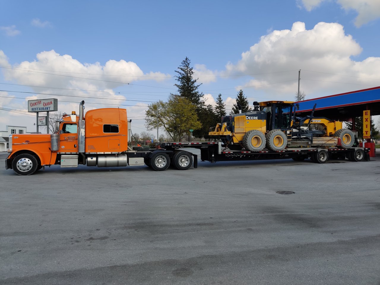

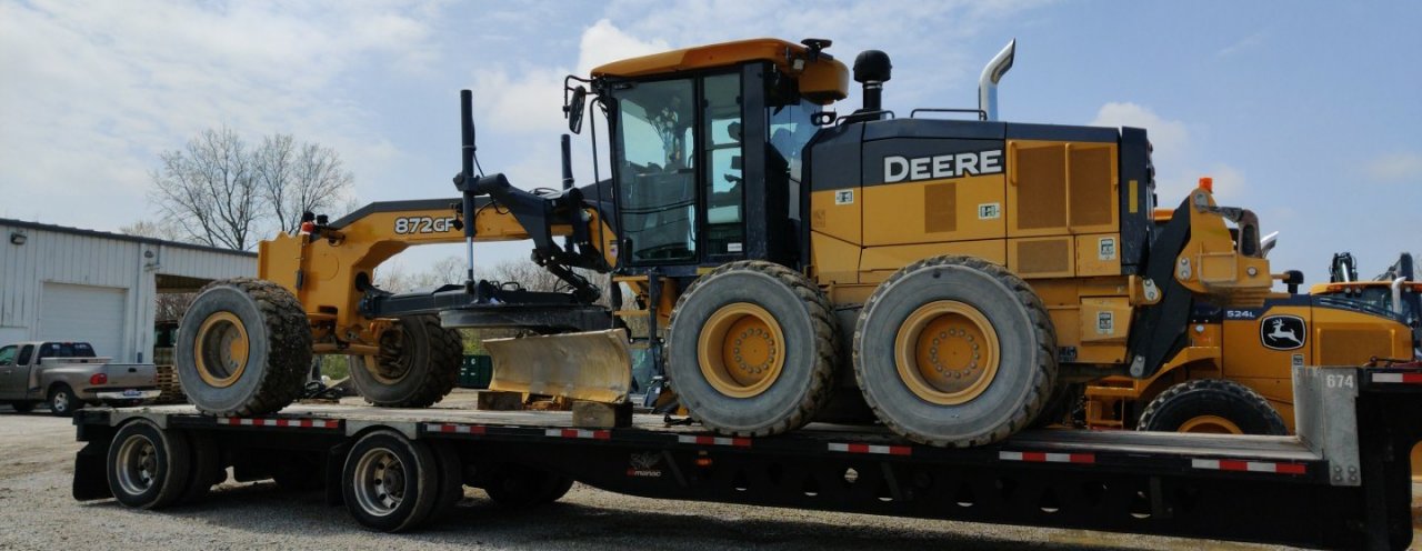

    Got ahold of a John Deere 872GP grader from Lima, Ohio going to Dodge City, Kansas. I'm only 13' 6" tall but I am 11.0' wide and 80,160 lbs. I already had to explain the 400lb. over-weight exemption for having an APU to an inspector at a weigh station. IMG_20200424_171102.jpg IMG_20200424_141345_01.jpg
