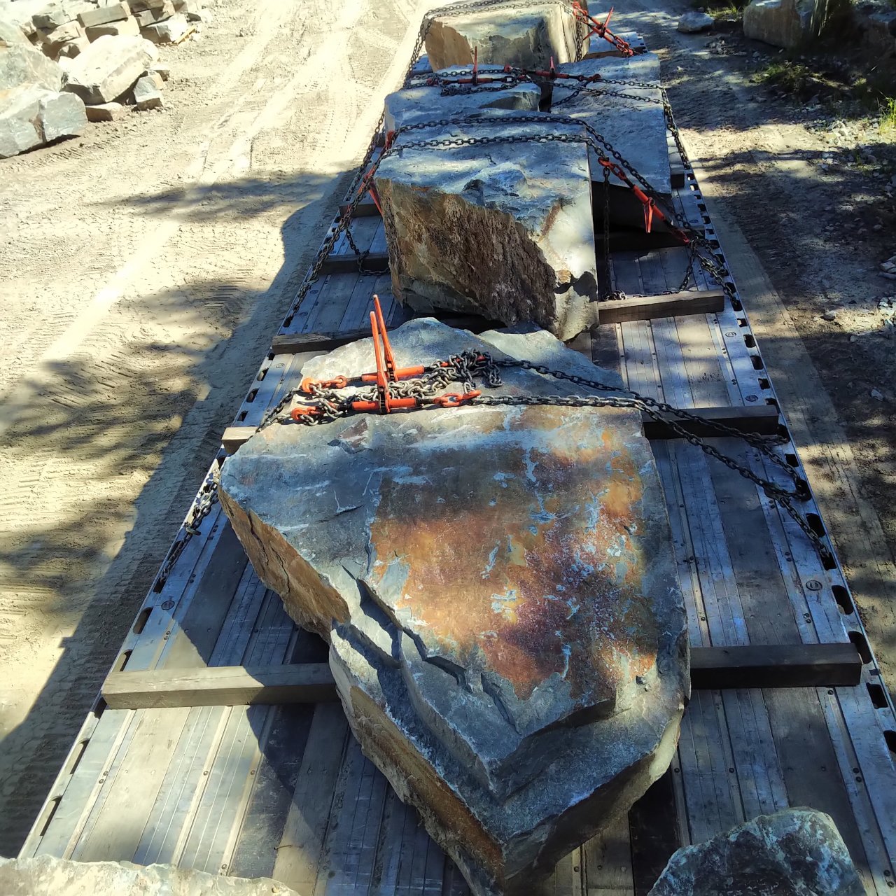

    Here was thursday load. Right before i failed my level 1 :(

    what happened?
    details!

    No paper log books
    "Chaffed" brake line
    And had a couple flat spots on inside trailer tire where it was wearing irregular.... The rest of tire had over 5/32 . The flat spots was in the inside groove and was 0/32..
    Tried to have tire replaced a month ago when it went flat on me. Company turned around and said no , just patch it.... Yep here we are a month later and i get the blame... funny how that works....i could tell ya if it was my equipment we wouldnt be having that convo...

    Yep he went thru all the ticky tack stuff . Including the eld instruction manual u are supposed to carry..never been asked for that before, but i had it.. He had a card , checking my securement, looked at weight ratings on trailer for securement... went under my trailer and dissapeared for a good 30-40 minutes. Yep i knew he was gonna find something, no matter if my equipment came right off the showroom floor.
