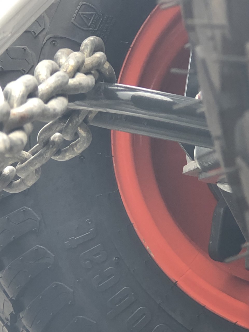

    Onto these for all of them except for the utility vehicle, instead I used that loop right there and it’s the same on the other side of it; man you got me worried now lol same dude who told me about the 2 binders 1 chain told me those were for towing

  5. daf105paccar
    6,564
    7,293
    Apr 15, 2012
    From the label,
    Don't hook to it but go thru it.
    There should be a second hole or it should be open on 1 side.

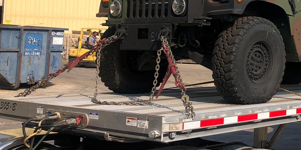

    I'm not sure why the 1 chain, 2 binders is such a sticking point for so many people, but you're not alone in the fact that most are incorrect.
    Here's an example of one I just did:
    Humvee's make it easy with the labeled d rings right out there in your face, but the concept is the same for anything you can run a chain through. Slack should always be in the middle. Look at your chain and imagine taking bolt cutters to the middle of it - will both sides still be tight?
  7. daf105paccar
    6,564
    7,293
    Apr 15, 2012
    Better then my crappy drawing. :):D
    Nostalgic Thanks this.
