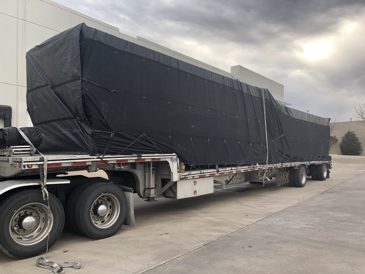

  7. midcon
    midcon Light Load Member
    61
    206
    Apr 11, 2020
    Before and after. These loads like this are the worst. Terrible wind drag and not enough weight for any momentum in the mountains = piss poor fuel mileage

  9. Ruthless
    Ruthless Road Train Member
    9,101
    90,263
    Aug 28, 2010
    The City.
    you pad that under the tarp? I don’t carry pads, and have refused a couple of those based on that- figuring I’m buying a set of tarps by the time it delivers// n they aint paying enough on short hauls by me to justify a set of tarps
  10. midcon
    61
    206
    Apr 11, 2020
    The ends and middle were padded and all the corners that contacted tarp had carpet pieces taped on. I’m old and slow so it took me a good 3 hours to get it like I wanted. It rode fine for 2300 miles. But like you mentioned there is no way I’d do that on a short run. (Unless it paid stupid money) Way too much work to keep tarps from being destroyed.

  11. midcon
    61
    206
    Apr 11, 2020
    Way I like to do those is pull strap through from the back and then once you have it tight just fold up excess so it’s about 8-10” long and place behind the strap on top of winch. Quick wrap with a bungee and done.
