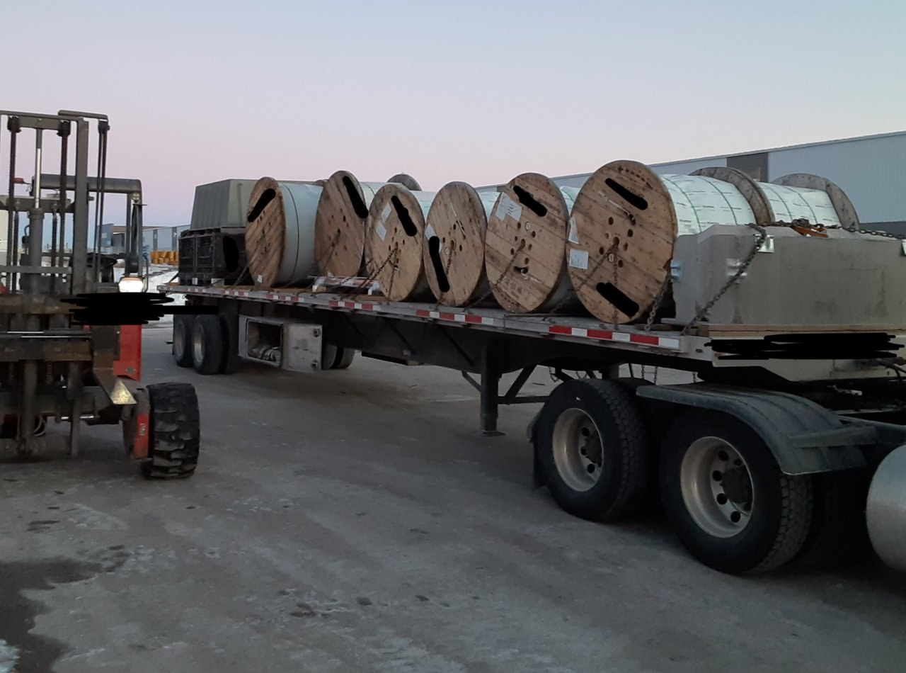

    I “made” a chain puller out of a 10 ft. Length of 1” metal conduit that I found in the scrap dumpster. I ran a small chain through the conduit with a loop at one end and the excess chain sticking out the other end, so as I pull on the chain, the loop gets tighter.

    Man thats genius. I just noticed how small that center hole is on the reels you haul... I was thinking maybe a long piece of baling wire and hook it around the chain end then feed thru and pull is what i would do but i like your idea better.. Do you have to take the hooks off your chain or do they fit thru that hole?

    I tried using wire in the beginning but it doesn’t work, the reels are hollow inside so the wire just sags before it makes it to the other end. I even spent a lot of time braiding a bunch of wire together to make it more sturdy but it still didn’t work.
    Then I saw another driver using a length of plastic conduit with a wire loop at the end, so I basically just ripped off his idea and made it better.
    Yes, chain hooks fit through the hole, can even pull two through at a time

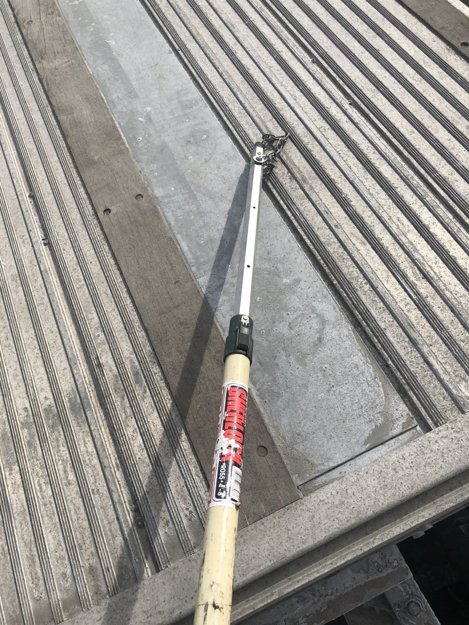

    I use an extendable painter pole with a small piece of chain drilled through the end with a loop of chain. I just hook the chain in and pull it through.

    Thats sweet. So do u just attach the hook end of the chain and push it thru ?

    Actually I pull the chain after attaching it to the end of the pole.
