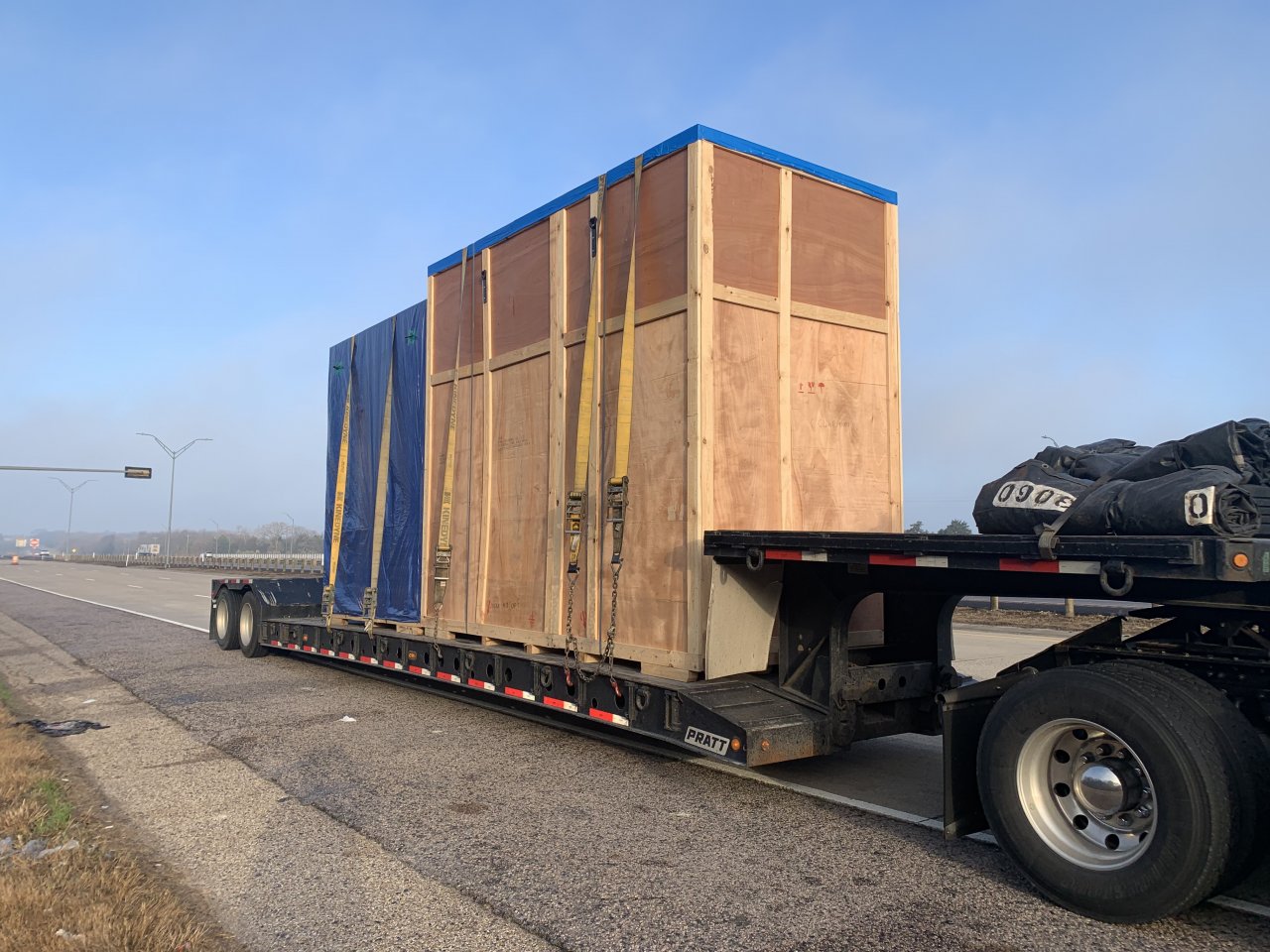

    I have probably close to 14 of them. We typically use them on double drops if the holes are to small to get a 4” hook in. But they are a pain in the ### to keep hooked on both sides as you tighten the strap. 26429808-1069-445C-BF2F-6FA8B02B3440.jpeg
    As for your step deck, I’ve seen guys do something similar to this with an even shorter chain, hooking on each side of the axle. 9296C299-2819-4239-AE9F-28D637378093.jpeg

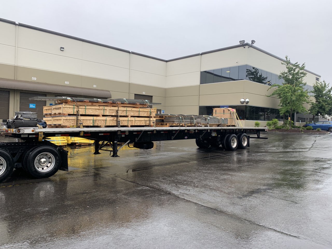

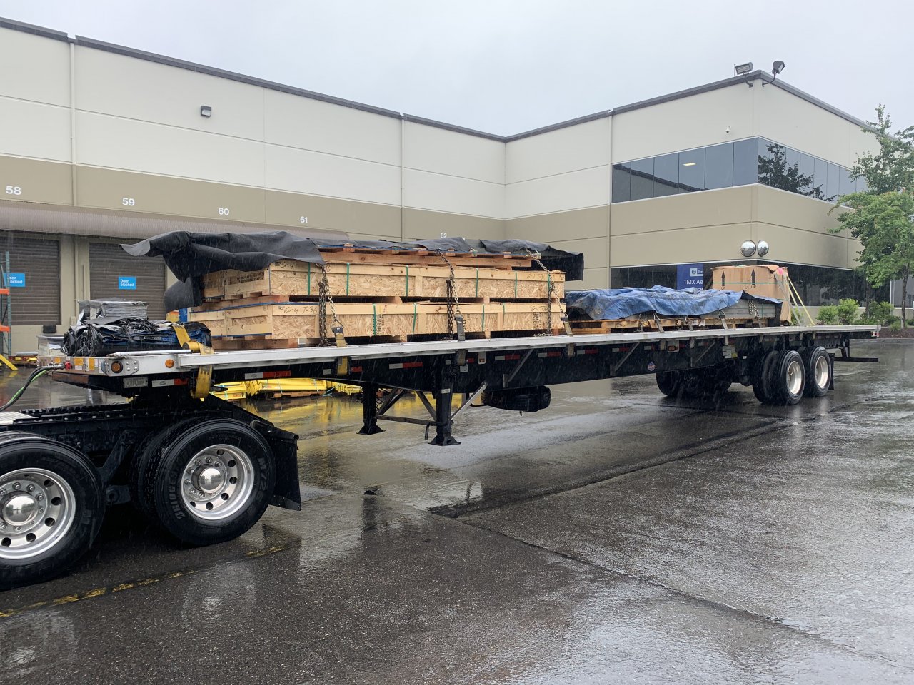

    Just curious, how come you chained that load versus strapping it?

    That was a load of scrap titanium plate cutouts. I wanted chains but also the ability to tighten going down the road without removing the tarp. B30360E7-5BD2-4C19-82A6-8017DA125CF0.jpeg 1F4D3006-790B-4EA4-8423-32342CD0D898.jpeg
