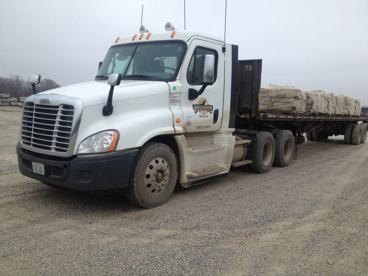

    Same #### different hole in the ground. Straight north and east of where it says “177” on the map.
    Used to haul out of US Stone Industries in Herington, Ks. Truck load after truck load of 4” full veneer back to our main yard to get run through the saw and turned into 1” thick thin veneer. Gravy loads, just heavy. And probably cheap but we’re were hauling for ourselves. 9C84FDF2-2126-4B3B-ACBE-DBF55D92F6ED.jpeg
