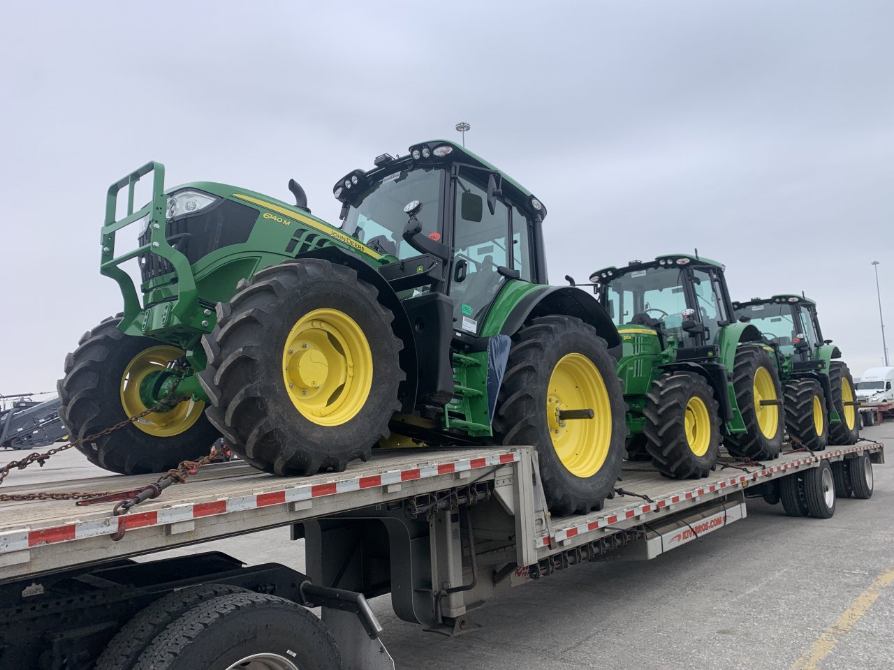

    Not trying to hate but is that legal to put your binder like that on the rub rail? Talking about the one with the green tractors and the binder closest to us. Also will the customer be able to file a damage claim to the paint wrapping the axles with the chain? I’ve never hauled them ever so just trying to learn.
