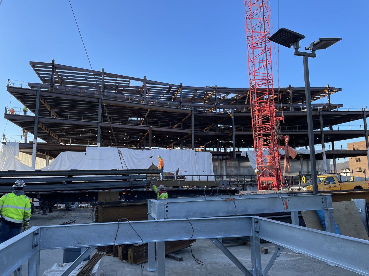

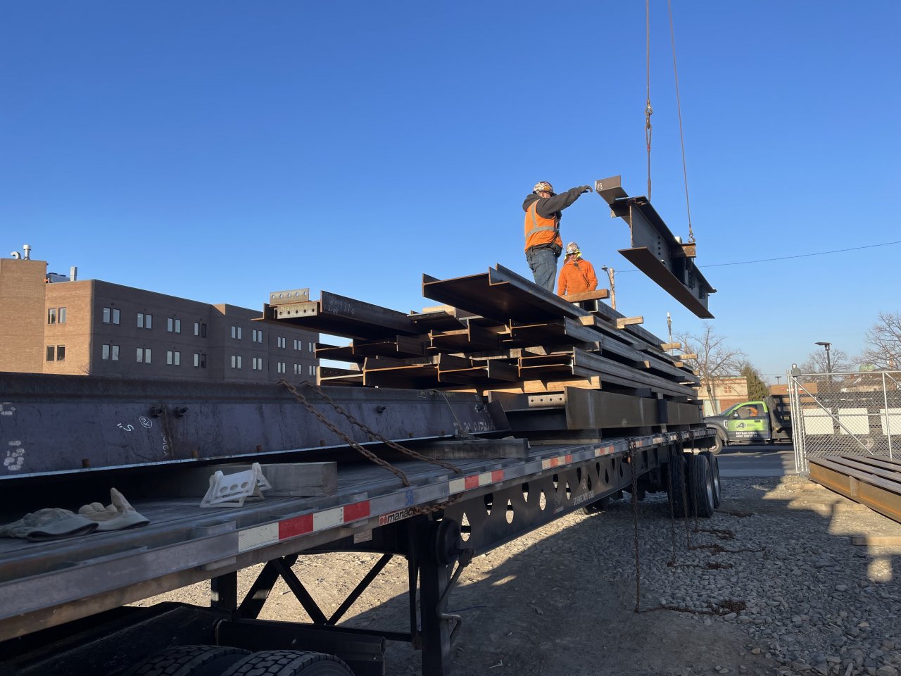

    Structural to Johnson City NY 50C99AC9-6F45-48CE-A7C9-6B36BB8D8034.jpeg 7D6B8E94-A44E-4AA4-B52B-3A5F97CA1A81.jpeg
    cke, D.Tibbitt, CAXPT and 3 others Thank this.

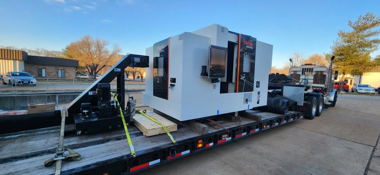

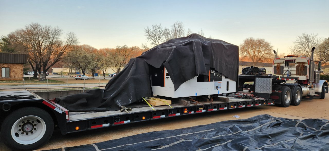

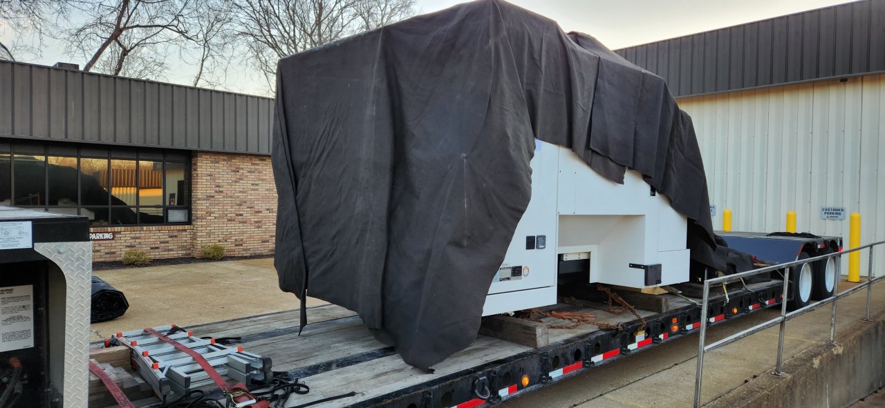

    This is how you don't get holes in your tarps. Polypropylene tarp protectors. Worst I've done in the past 10 yrs is have a bungee hook wear thru the tarp.
    cke, D.Tibbitt, CAXPT and 6 others Thank this.
