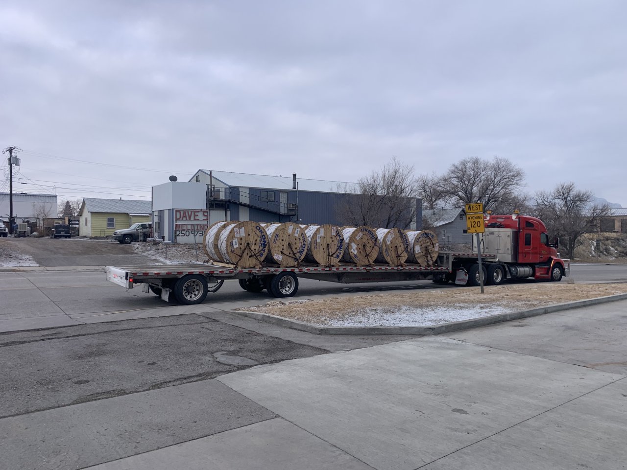

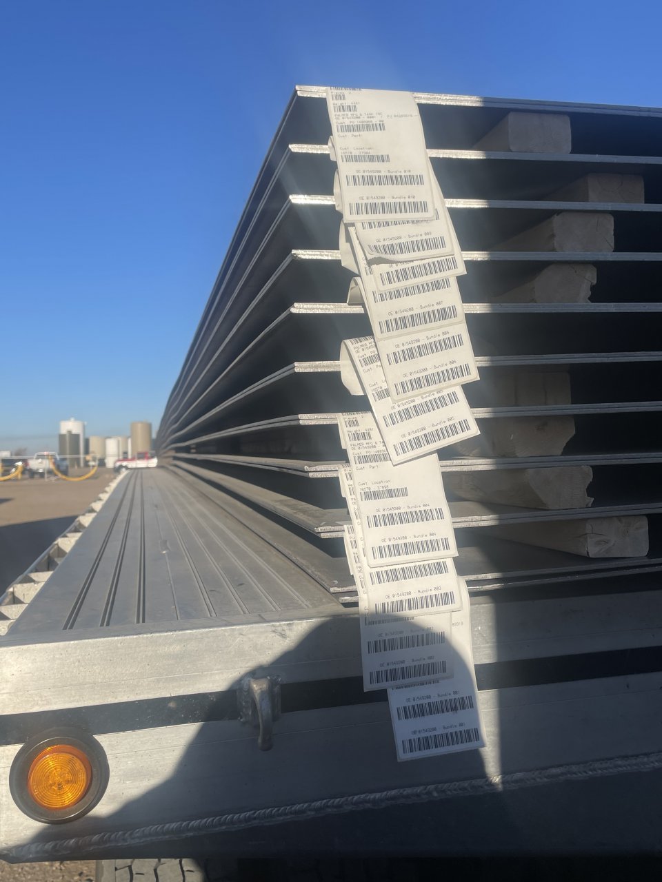

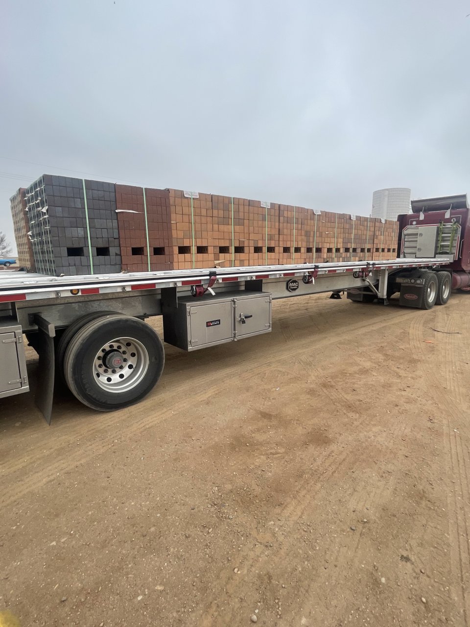

    I swore I remember CO outlawed snap binders but maybe my memory is hazy. I googled it but can’t find it. I’ve also had a shipper only want ratchet binders one time. Anyways here’s my last 2 loads. This week wasn’t nearly as profitable as last week.

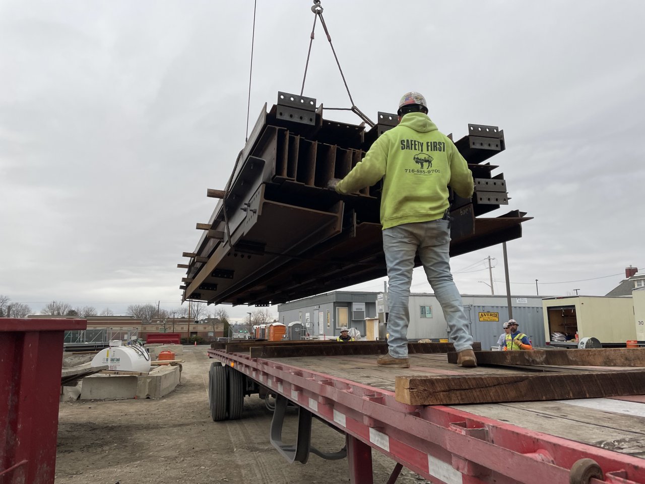

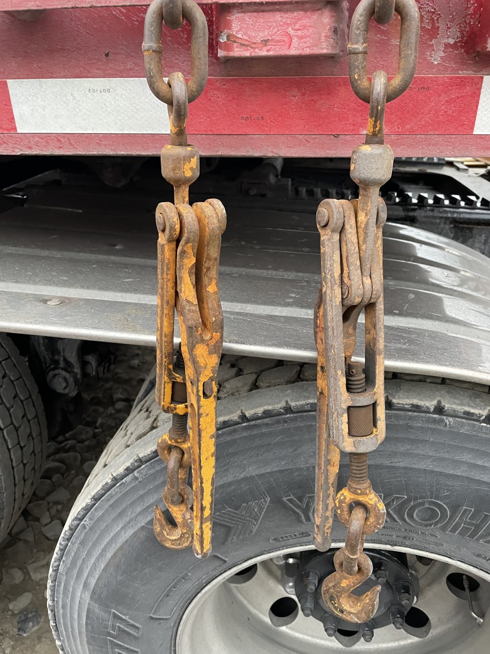

    I remember someone trying to tell me that snap binders were illegal about 15 years ago but it never came to be.
    These are the ones we use on structural. Pretty slick cuz they’re adjustable plus they lock. Snap binders are so handy with structural cuz you can take up so much slack with just one motion. Sometimes with a ratchet you can wind it tight but then have to redo it again to get another link in the chain. If I’m hauling a single bridge girder I prefer ratchets cuz you know you can get them tight. Sometimes with a snap binder, one link on the chain is too loose but the next link might be too tight.
    These adjustable ones would probably cure that… BF12C52F-856E-4C3C-882C-0CA8C7525EE1.jpeg

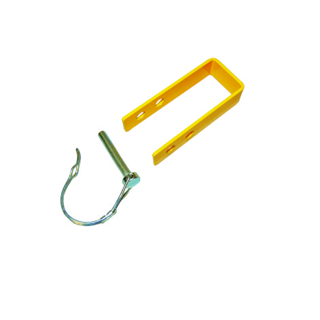

    What you might be thinking you heard, was that DOT does want snap binder handles secured, and you can no longer use a bungee to lock it closed. That's why these should be part of your equipment when using snap binders, which I did, since I preferred them. It's a handle lock.

  9. CAXPT
    CAXPT Road Train Member
    3,306
    15,426
    Feb 10, 2008
    Michigan
    Yep, the built in lock is what makes these legal...and I do like that adjustment screw. It's the one thing I wish the ones I used had, but they are more expensive so a lock on the handle is fine with me. :)
