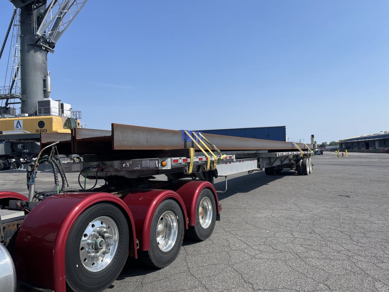

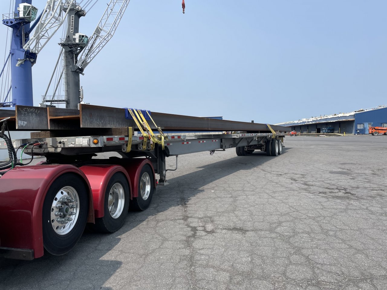

    Two trips today Albany to Schenectady. First load was 74’ second was 83’ 84B68480-4A45-48B5-9EC9-EAB64D03FBD1.jpeg 9882EC10-7BE2-40DC-BC62-3B6691B24957.jpeg
