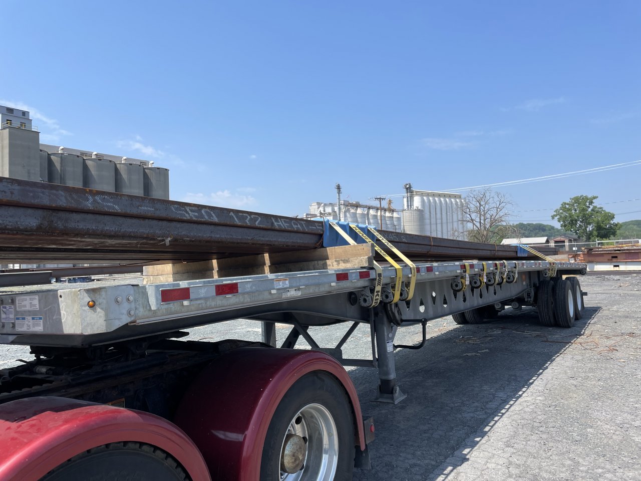

    I have no complaints about your ways of securements, actually seems easier, however, with the regulations, aren’t the loads required to have 2 securements the first 10 feet and 1 securement every 10 feet after that ?

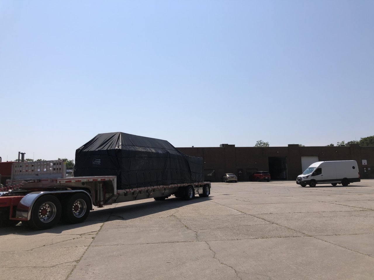

    3B6ACF71-3402-40A3-A1EB-E972D6338387.jpeg C2016CDC-76F5-4107-BC98-D4FB7690BF53.jpeg
    O is it 90° and humid? Sounds like a possibility of rain to me.
    Opened up right when i got back too
    NoBigHurry, CAXPT, Gatordude and 9 others Thank this.
  6. Diesel Dave
    9,249
    29,589
    Jan 20, 2010
    Hesperia, Ca.
    Tarping in that kind of weather, you got your “Cardio” in for the week…. :D

  9. booley
    booley Road Train Member
    1,457
    9,997
    Feb 16, 2008
    @Diesel Dave I questioned this myself and I believe (and could be wrong) as long as there’s enough securement for length and weight, I’m good. Those channels were 50’, I used 6 straps. When I was hauling precast, we would only put our tie downs near the dunnage to avoid the risk of cracking the concrete. I actually had quite a discussion with a DOT officer about this a few years ago (and didn’t get written up)

  10. D.Tibbitt
    22,229
    152,941
    yes you are right. only need them for every 10ft worth of freight..not every 10 ft in continuum.. so 50ft of freight needs 6 straps like you said.. doesnt matter where they are, just that there is 6 of them...commonly misunderstood rule... i dont remember who posted that regulation on here awhile back, but it has been posted before

  11. Diesel Dave
    9,249
    29,589
    Jan 20, 2010
    Hesperia, Ca.
    I do the same since most of my loads local, pushing it……. I believe we have some loop holes we can get away with.
