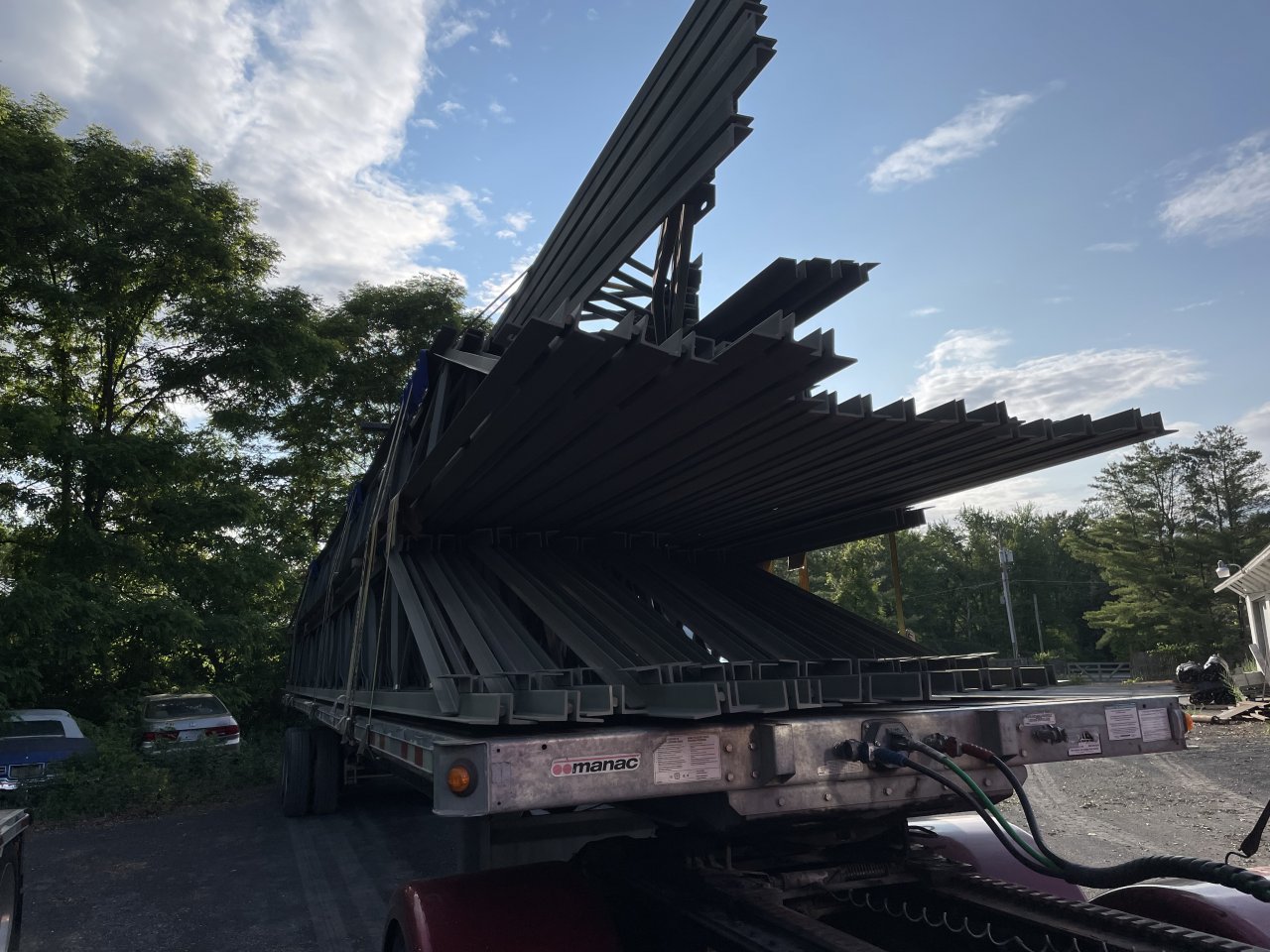

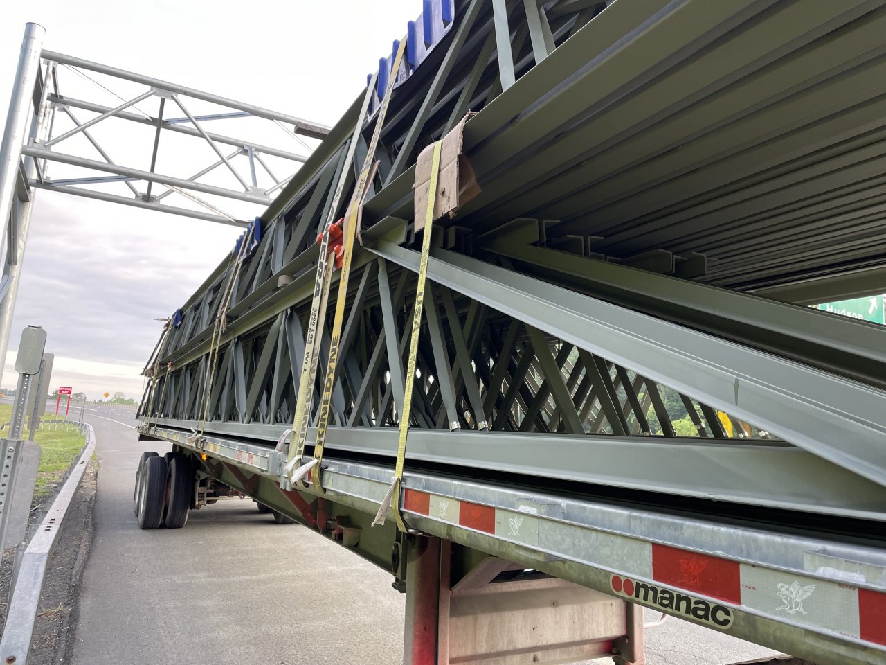

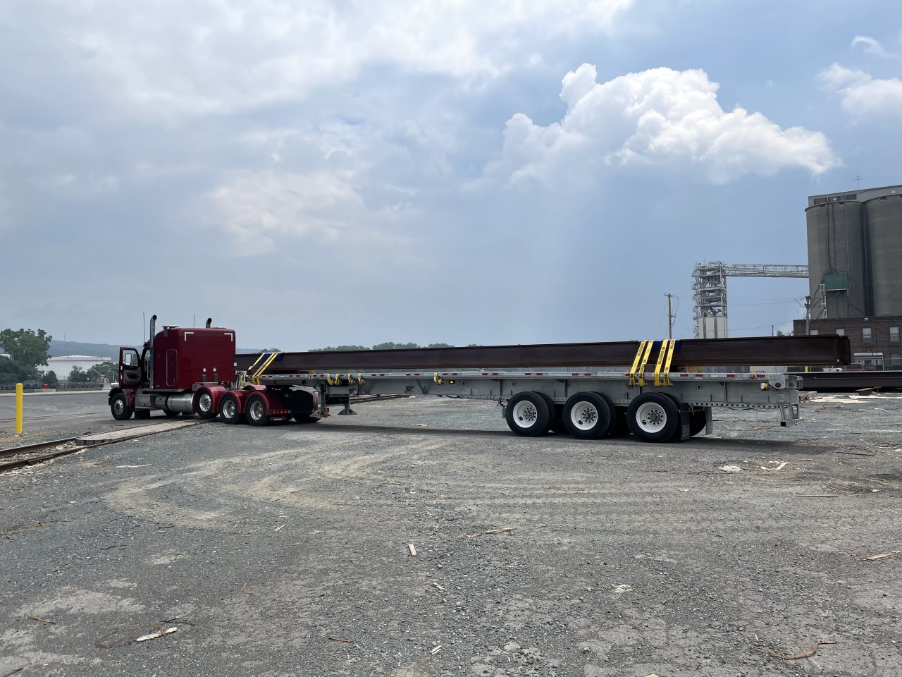

    60 ft beams from Albany to Schenectady, 2 times. I’ve repositioned my straps to be right over the dunnage :) 88C7B2EE-A6D2-4A7F-B03B-60595AFAD347.jpeg

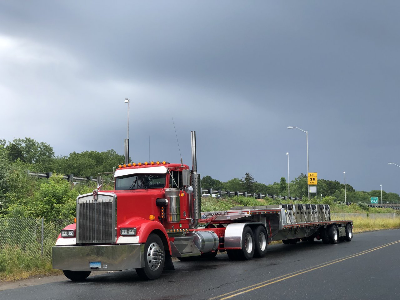

    Bar joists to E. Hartford Ct. This was a load I wished I carried a bunch of light chains for…
    Placing all those corner protectors was a pita! F9DA8D17-C151-418A-8EDE-0BD55DD0F204.jpeg F83CAC6C-DDBA-4847-A151-CF48AD546DBF.jpeg

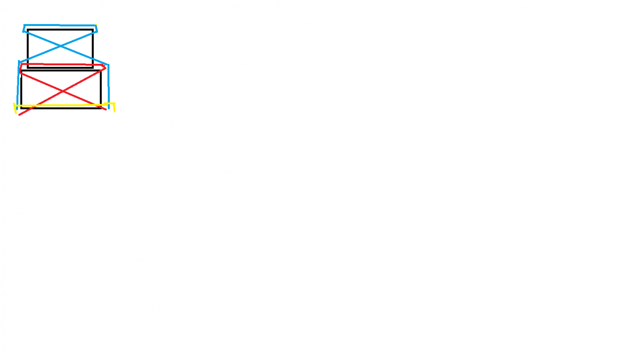

    The last time I hauled steel joists (1979?) I was 3rd load into a warehouse project and the first to arrive with them all standing as they were loaded.
    I ran 2 25ft 5/16 chains "Xed" on the bottom layer tying the top layer to the bottom and 2 30ft 5/16 chains "Xed" on the top layer as well as 7 straps over all and 2 shortys locking the bottom in place

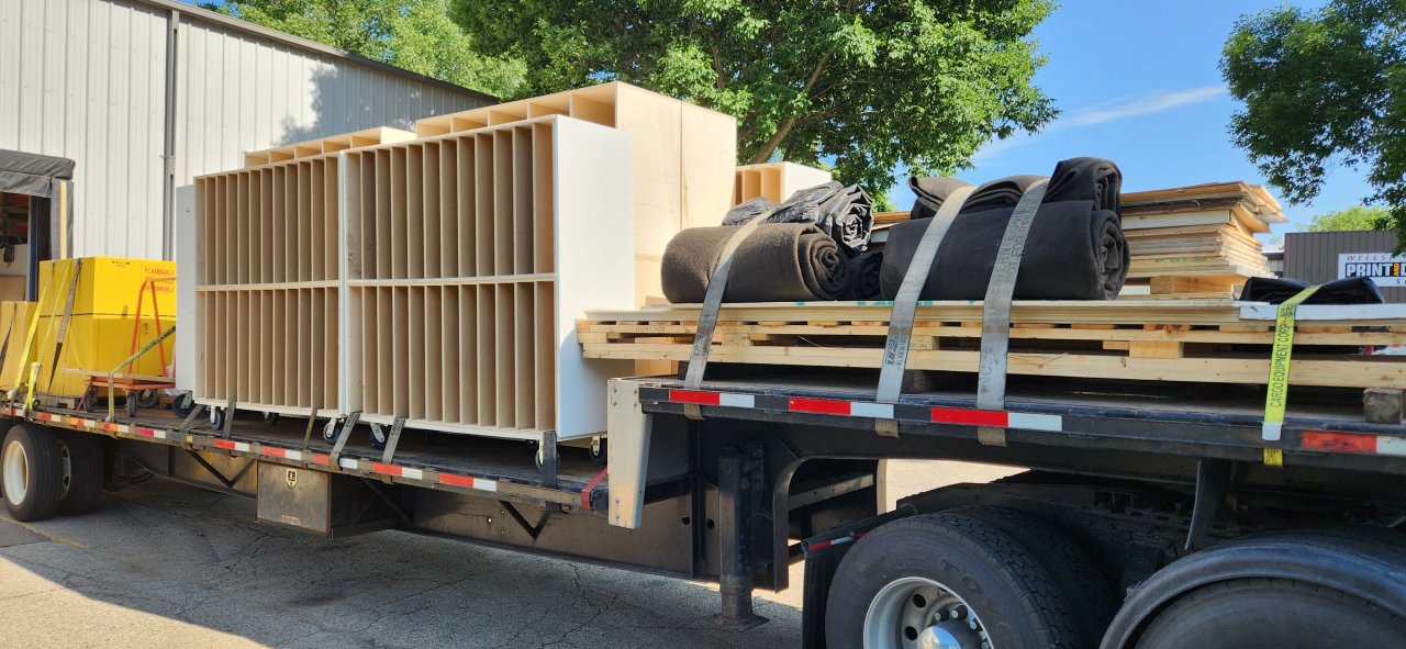

    Todays fun.
    20230609_164908.jpg 20230609_164851.jpg 20230609_164836.jpg 20230609_164828.jpg 20230609_115054.jpg
