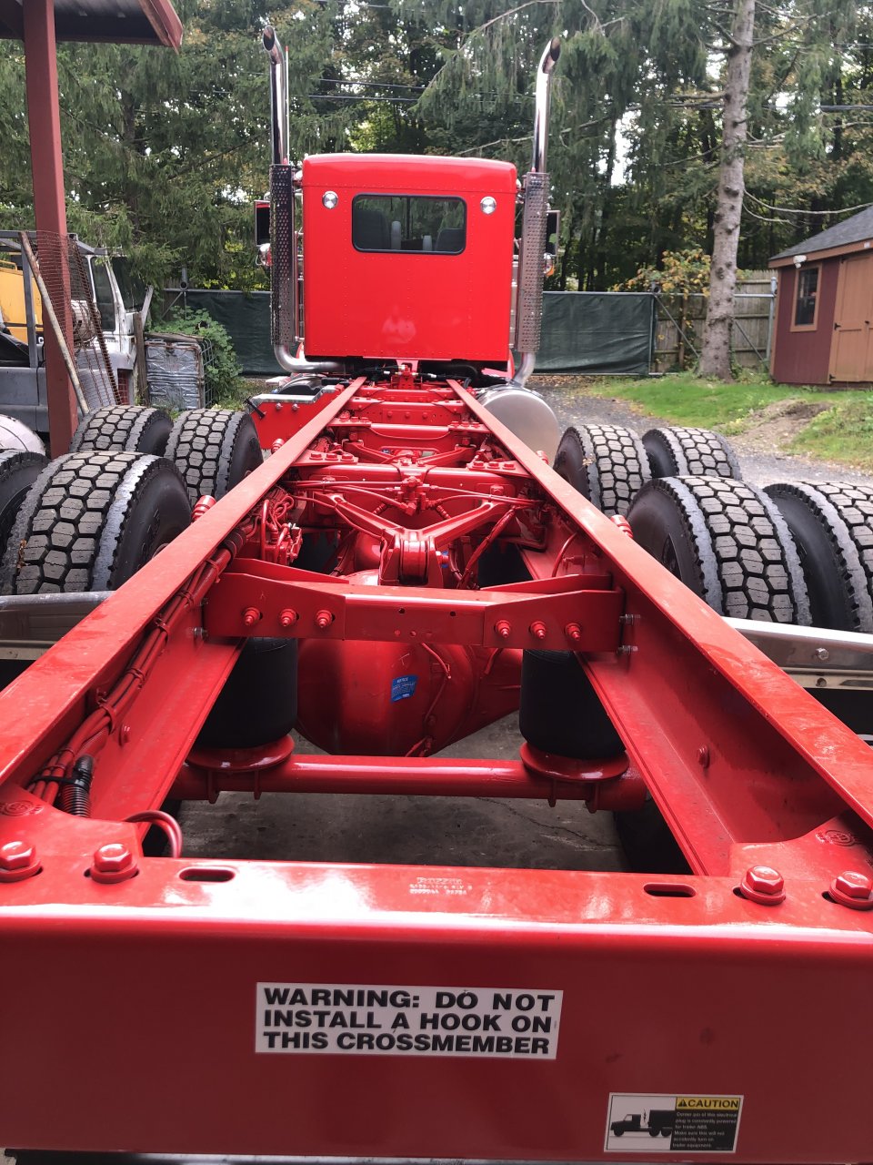

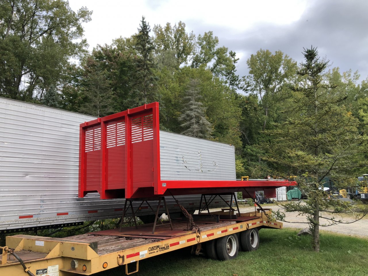

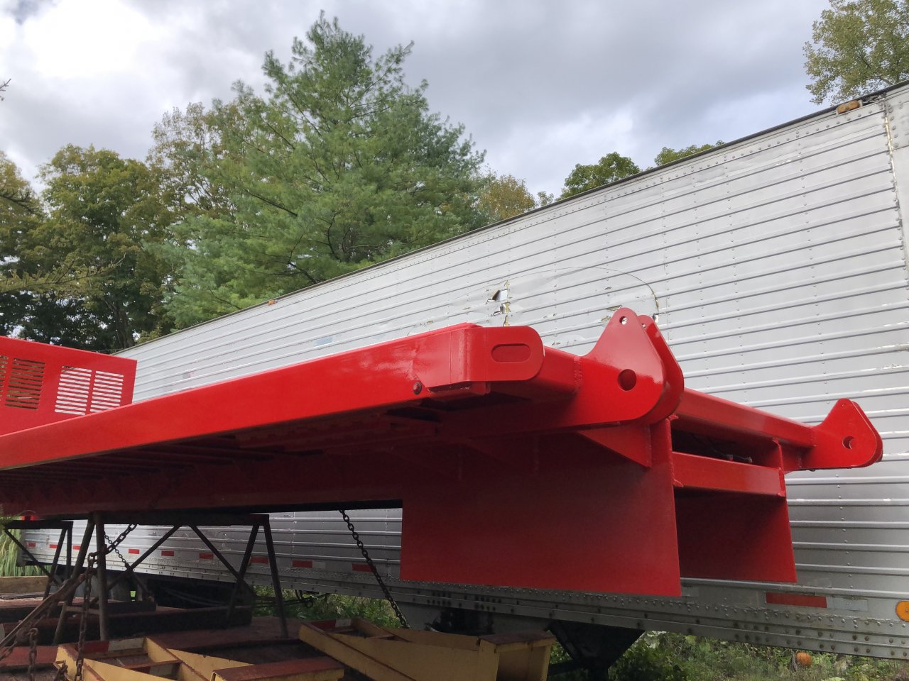

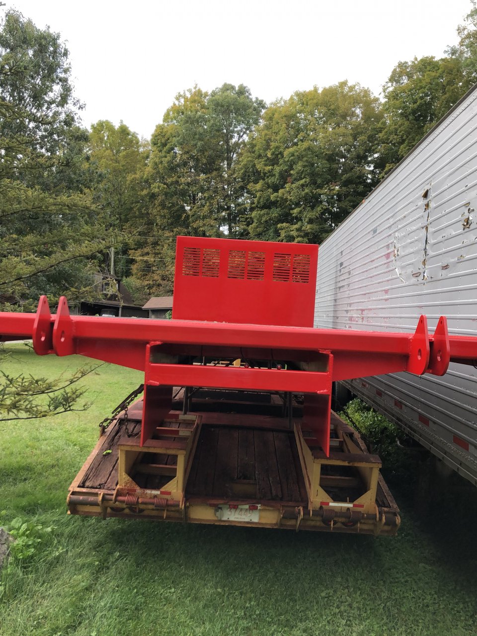

    Its finally coming together
    1372E05C-839E-4EA4-9A6C-E80A85A77757.jpeg AEED13E1-96A3-4991-B215-F6F1A75031A7.jpeg DA04596A-AFE5-471B-9DE1-7127A5AA4F3A.jpeg 849C689E-3972-4771-99D3-9E093EE2D1CA.jpeg DCD8662D-3866-4BD0-AE5C-DED684F701D4.jpeg

    I made money with the last one I had when I ran it.
    Gonna tell everybody- load, size and load weight is now cut in half, and rates are going up!
    more steak more lobster!

    That's a substantial investment.
    I know nothing of your weight laws; will you be putting a tag axle on? Looks like maybe you would have rom either ahead or behind the drives. With the Moffet behind might work better. Just spit-balling here, I don't know if it would be worth it or what would work better.

    Different locales have substantially different weight laws:
    MA 20/52 rated you get 70k on
    CT 20/46 rated you get 60k on
    NY …. Is it 55k on 3 ? Sticks in my mind
    add a steerable drop (NY requires axles that lift to also steer for divisible overweight permit)
    NY is still lower but i don’t remember to what
    CT is like 72.5k for non aggregate loads ( 76.5k on 4 if its jobsite material)
    I gotta scale it when it’s all together with, and without the machine to see- I think it probably would be worthwhile to have a 20,000 pound steerable drop, for lawmens prying eyes, if nothing else
    I won’t know the exact numbers without that scale ticket in hand but I’m going to guess that body on that chassis should net me somewhere in the realm of 17 1/2 or 18 ton @60k
    Hopefully it wasn’t one more huge mistake in my life Ha ha ha
