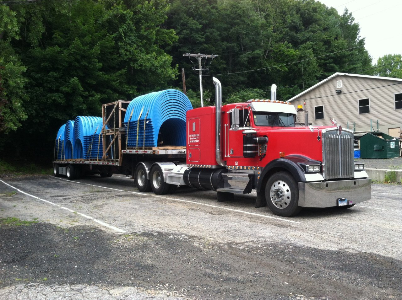

    What the heck are those?? Some sort of underground leaching chambers for stormwater?? Fryburg's ok, I drag rebar into the Harmac plant there every now and again.............come back for the fair in October!
  10. Ruthless
    Ruthless Road Train Member
    9,006
    89,019
    Aug 28, 2010
    The City.
    That's exactly what they are. Went into the new school, under what will be the new parking lot.
