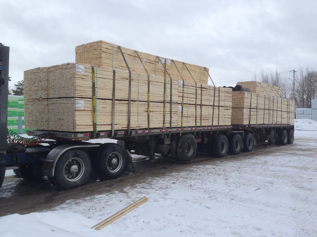

  7. Dye Guardian
    Dye Guardian Road Train Member
    1,329
    12,583
    Jan 10, 2015
    North
    Homeward bound.
    Are you tired of my lumber yet?
    Sleepy68 and PeteyFixAll Thank this.
  8. spax
    spax Medium Load Member
    361
    364
    Aug 5, 2011
    United States
    Not near as much as all that frozen white stuff in the background of all your pictures.....I get a chill everytime
    tsavory and Dye Guardian Thank this.
