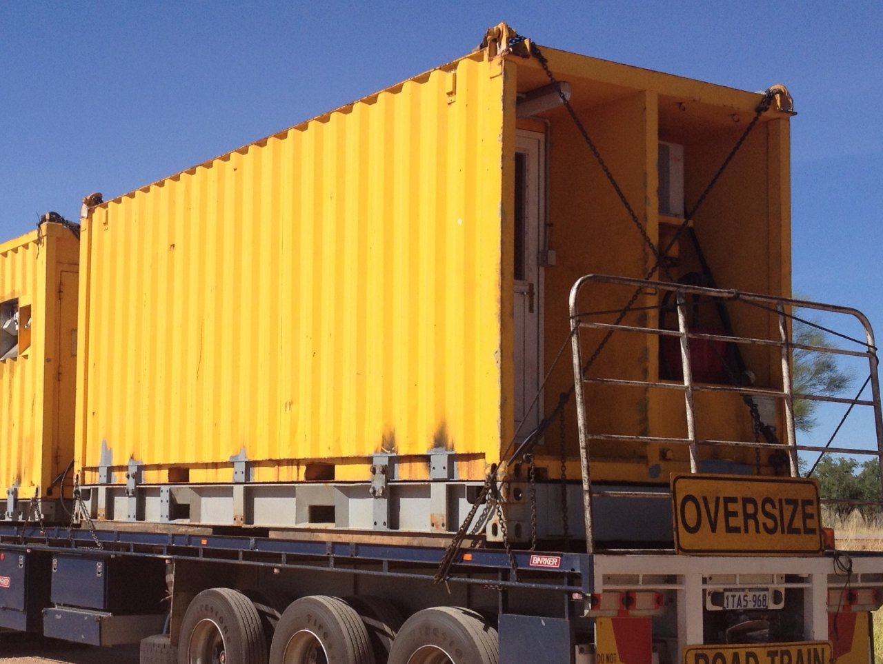

    I think the crossed chains like I did it is superior with each top corner having great force pulling it down towards it's opposite corner. That's also two chains instead of one.
    I wouldn't say you were wrong but I think this way is simply more effective.
    I've seen the way you've done it too. Maybe I would if they were empty.

    That's how I would have done it as well, except I position the chains at the bottom of the container so it can't move forward or back.

    I was just wondering. Always trying to learn. I would agree on greater down force.

    It stops them sliding sideways when they are cross chained.

    Ya I get that with the cross chain. I think my way would stop the sliding sideways as well though.

    Mine are all providing some forward/rearward force at the bottom but not exactly like yours are set up.
