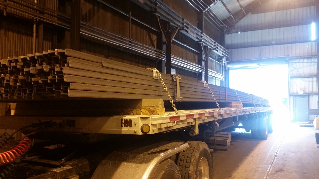

    I picked up this stuff today, never hauled it before. The guy said everyone usually just straps it. In light of some recent events I decided steel on steel was best cept for the 4 belly wraps I did. Prolly way over done but it feels safe. I put a chain at each board and one at each of the middle sections to get it to bow a little.

  6. MACK E-6
    49,250
    230,453
    First of all, there are far better sources of info here than I, as I haven't pulled a skateboard in 12 years. :)
    But the company I did run for only used 3/8"chain, and 1/2" binders.
    For coils, I'd want 1/2". One can never have too much on a coil. ;)

  7. johndeere4020
    8,522
    119,293
    Jan 1, 2010
    I see what your saying but a 1/2 chain doesn't do much good hooked to a 5500# stake pocket.
  8. MJ1657
    MJ1657 Road Train Member
    7,521
    50,152
    Jan 28, 2012
    Isanti, MN
    1/2" chains would be of no benefit on a standard flatbed trailer. The wll of the trailer securement point is no where near a 1/2" chain wll.
    Edit: posted same thing as JD 4020
  9. MACK E-6
    49,250
    230,453
    Nice job.
    I like the idea of the belly wraps. :)
    It never ceased to amaze me how many people thought all there was to load securement was "oh, just toss a strap or two over it and call it a day. ":rolleyes:
    One of those same yahoos would likely be baffled at how and why some of the middle pieces are working their way out of one end.
    PeteyFixAll and Chewy352 Thank this.
  10. Chewy352
    Chewy352 Road Train Member
    1,797
    11,619
    Dec 17, 2013
    Enid, OK
    Next size up is 3/8 which has a wll of 6600 lbs. I can't remember what my spools are rated at off hand but I know it's less then that and more then 4700. My chains are the weakest point in my securement so that wll is what I always remember.
