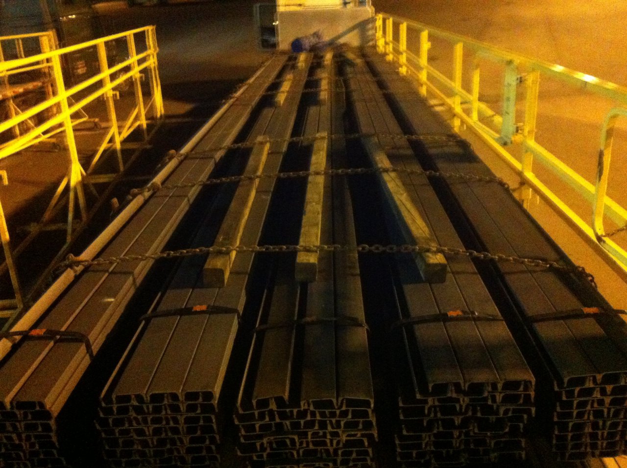

    So short upright pieces between the rows, chain and choke like usual. Makes sense.

    I would have gone over/under each individual bundle and make sure to tighten them enroute. Huge pain in the ### and I hate it but I don't see it as a secure load without doing it that way.
    Only once have I done a load with spaced out bundles of steel that I felt was secure going over the top like you did it, it depends on the product some as well.
    I'd rather not even do those loads TBH.

    Well, don't be afraid to post here again in the future! And pay attention to what other guys are doing as well, maybe ask them questions while you're at shippers if you can. Although, I see a lot of trucks hauling steel with straps straight over spaced out bundles... Most trucks. This coming from the world of multi-axle where we almost always have more than one layer. I don't like it so I won't do it.
