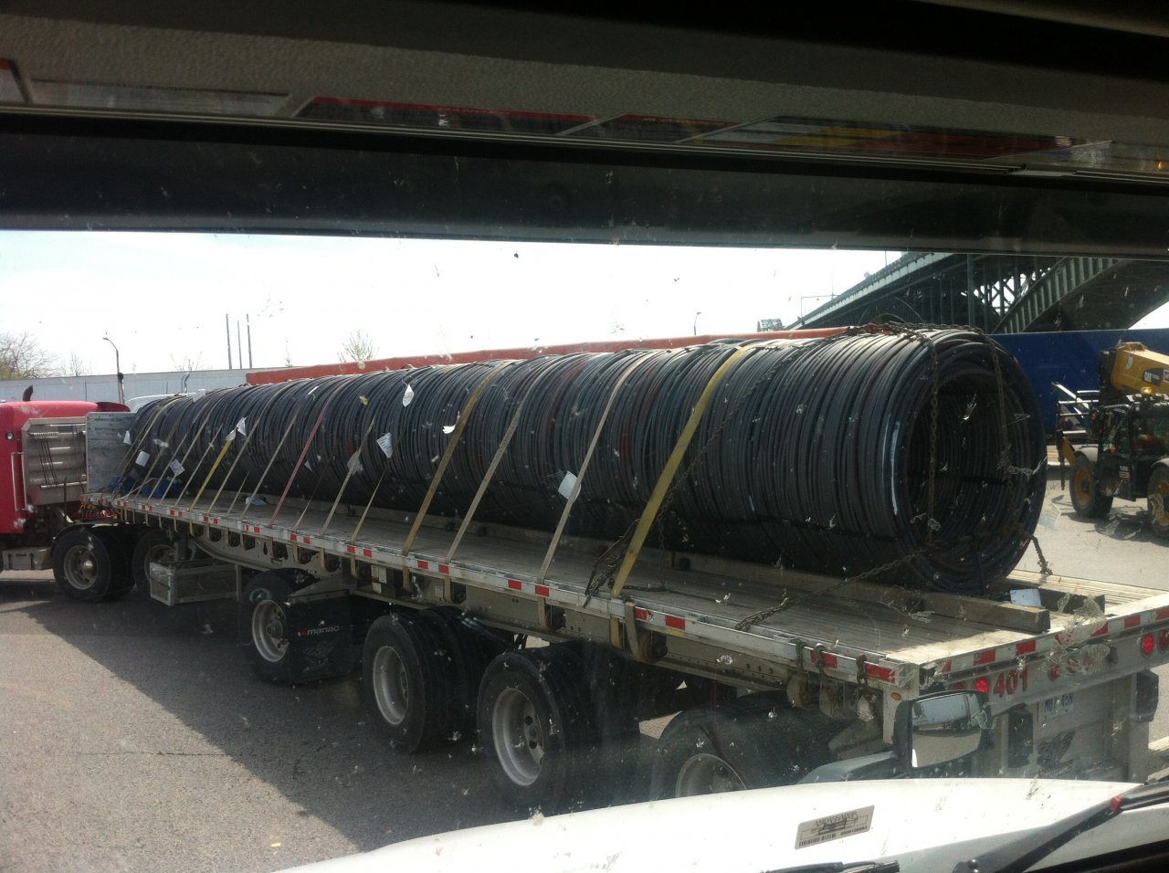

    It's obviously hard to see in the picture, he had the extra "tail" rolled up on the outside bundle. Which raised the strap one inch off the inside bundles (6 per row). So not only were the bundles all catterwampus, the straps were only on the 2 outside bundles. One good brake from being a hod ornament. If he'd have choked, then strapped, different story.

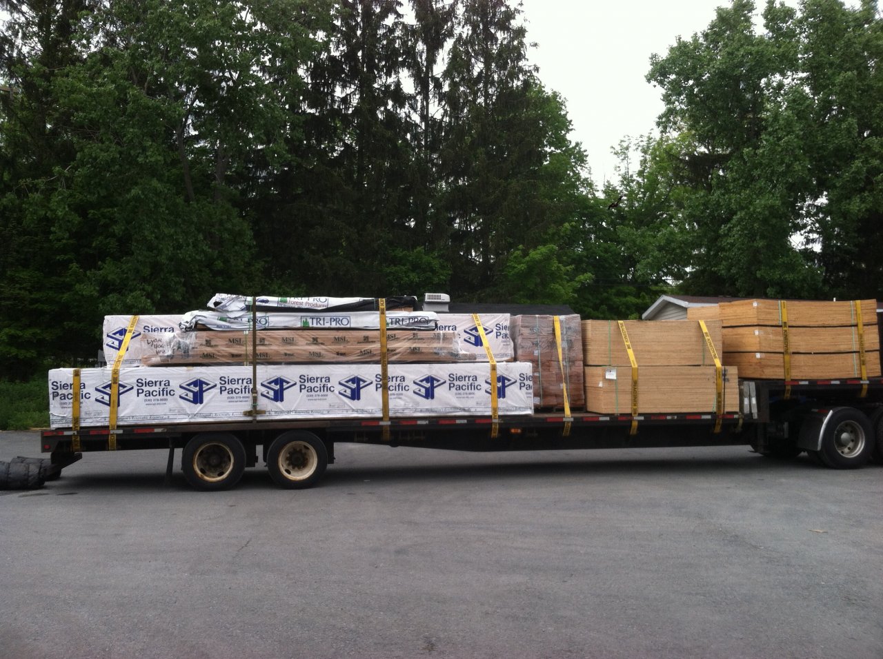

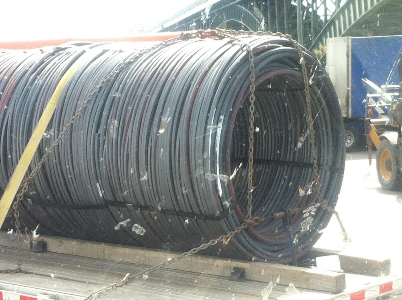

    I'll see your steel block, and raise you some steel coils. I was impressed with the chain work on the rear coil. image.jpg image.jpg image.jpg

    That Sierra pacific has traveled a long ways!!

    The X is laying chain under the corner pull up along face over top and connect other side. Thus me not wanting ANY forward movement

    "Washingtons Renewable Resource"

    They put that on every package. Either Wa or California renewable resource. Here it's always heavy and pays cheap.
