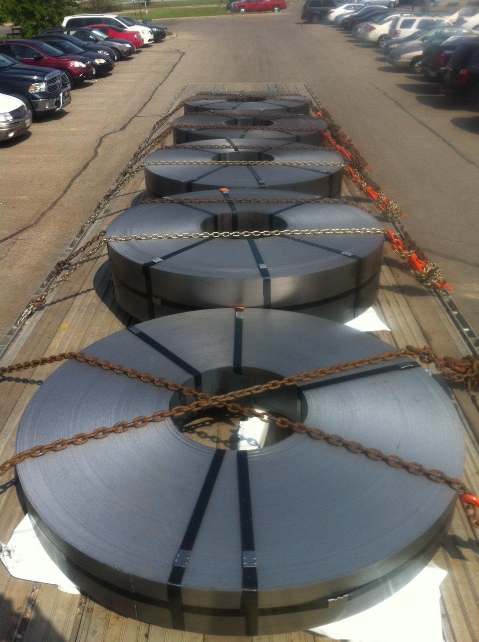

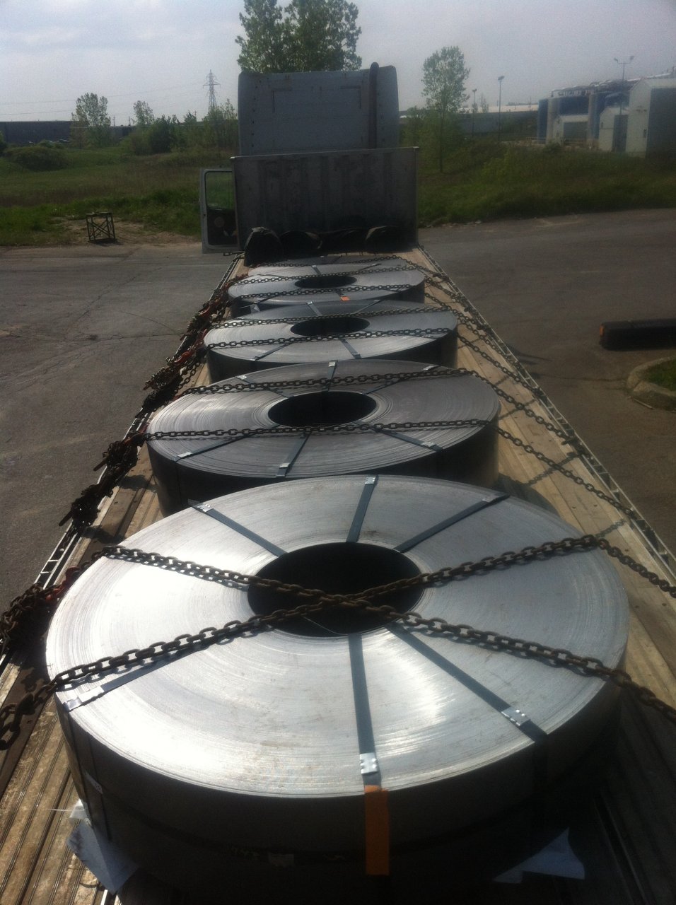

    I think I would of "X"ed all the coils. I don't think i'd trust the chains to stay on the center 3 the way their on there.

    A stupid story about this type of load. Stupid because I don't know what the driver was thinking. But he had the same load on him and it had a tarp on it. Pulled into a full rest area so he had to park on the sloped shoulder for the night. I don't know if it happened during the night or when he pulled out but the center coil slid off the trailer. The driver gets to the consignee and discovers the coil missing. Now this is a true story because another driver was passing the rest area and saw a wrecker lifting the coil off the side of the road. The only thing I could say is WHAT? Created a lot of questions in my mind.
    On a side note I would put 3 chains on the front and last coils x-, 2 x chains on all remaining coils all with steel edge protectors. Also if you didn't want to build a bulkhead, put a trip chain U around the front and rear pallets.
