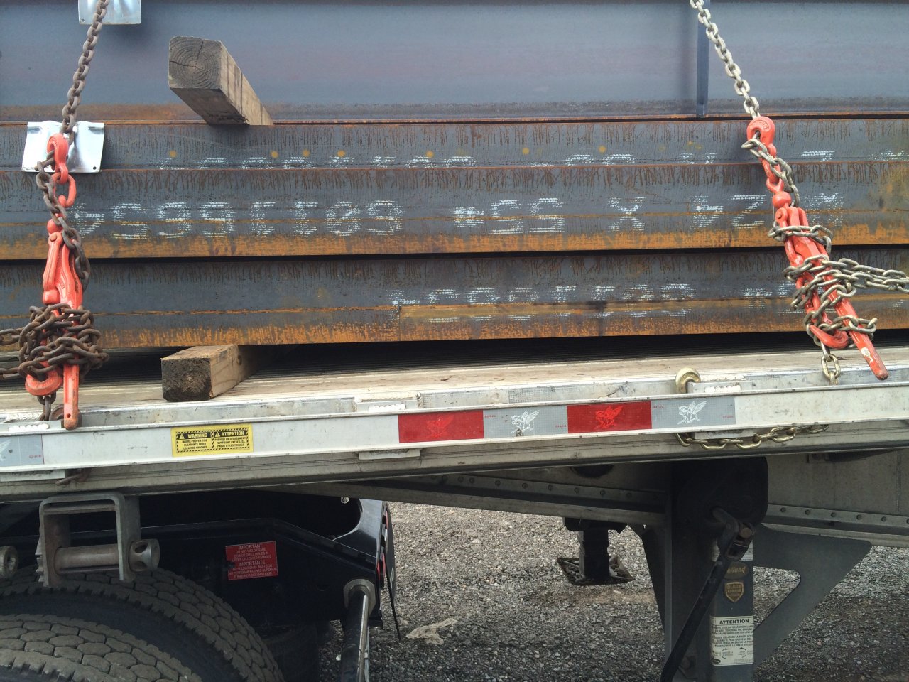

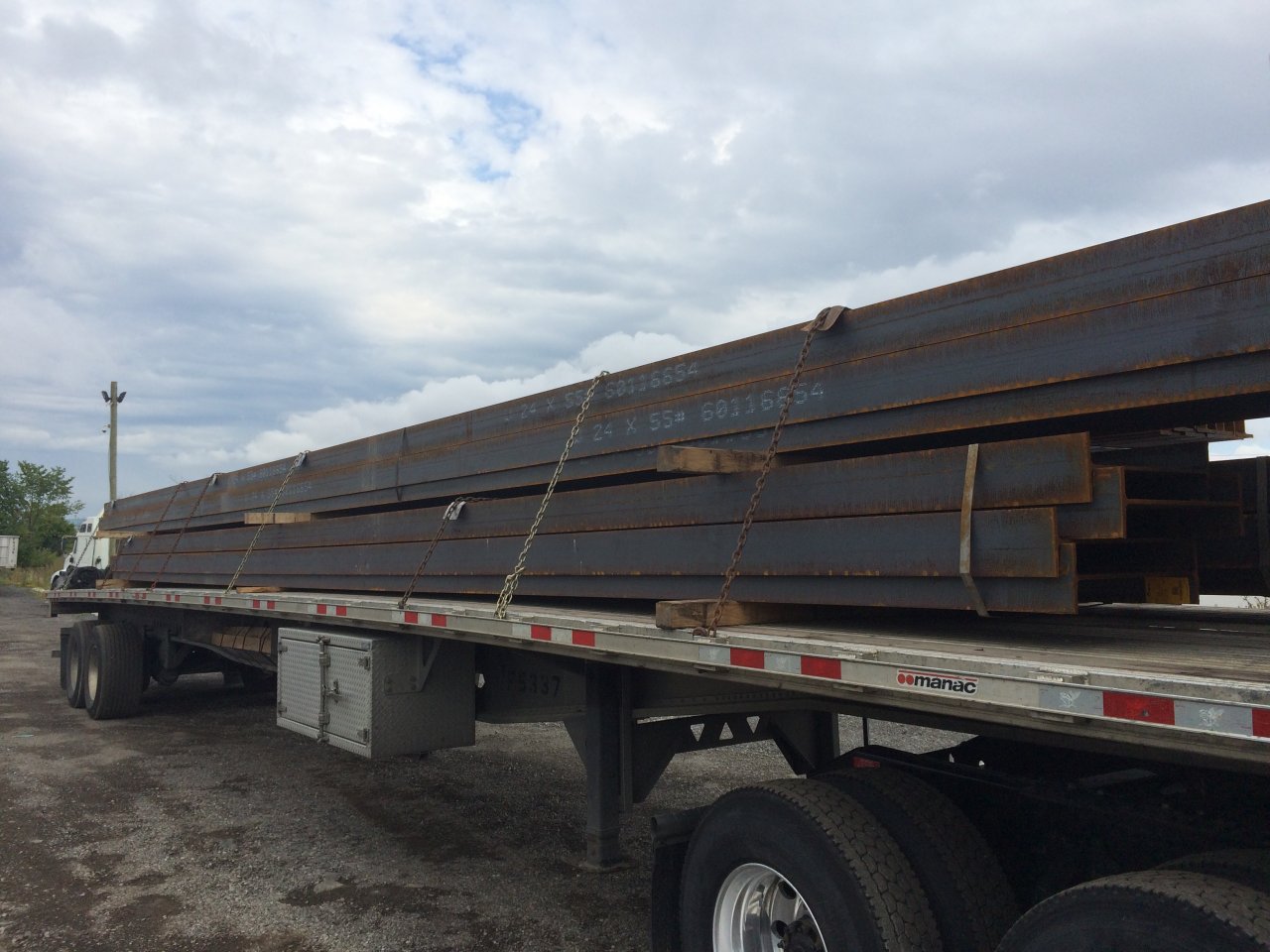

    Headed back to Virginia. This was preloaded by someone else, with 6 chains. I threw two more. Loads 42,000 lbs. I don't like how the back is hanging midair.
    Any criticism? Advice?

    Move the chain up next to the dunnage. With the flexing of the trailer and the steel that chain can come loose. But if you have it next to the dunnage you can really crank down on it.
    If you are going to put chains every 10 feet then you also need dunnage at those points.
    Just imagine going down the road, trailer flexes up in the middle and the steel down then WHAM! they bounce back and are stopped by the chains. Really good way to damage the securement and or the trailer.

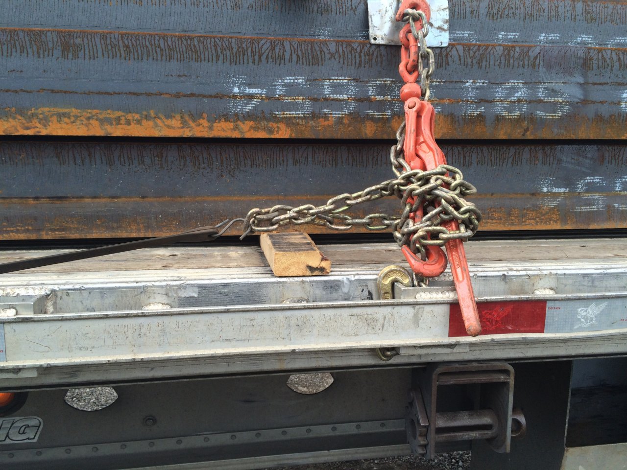

    Makes sense. Thank you, I moved the back one. There is 6 total pieces of dunnage, 3 on the bottom 3 in the middle. So to do it properly more use more dunnage, and place chains near the dunnage?
    I also don't like how they use different size dunnage.

    Here is a perfect example. 68' long and that stretch trailer really bounces going down the road. The concrete however does not hardly flex at all. But the only securement points are at the ends right near the dunnage.
    Yep if you want to do it the safest way then put dunnage where ever you are going to be placing chains.

    Looks like they did that because of the bow in the deck. The middle layer dunnage is the same thickness all the way across. I'd be more worried about the center dunnage crushing and giving slack to the chains
    TripleSix and DDlighttruck Thank this.
