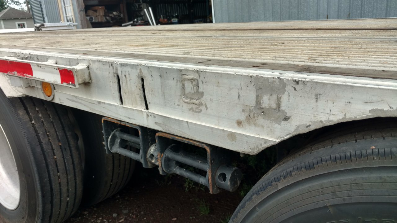

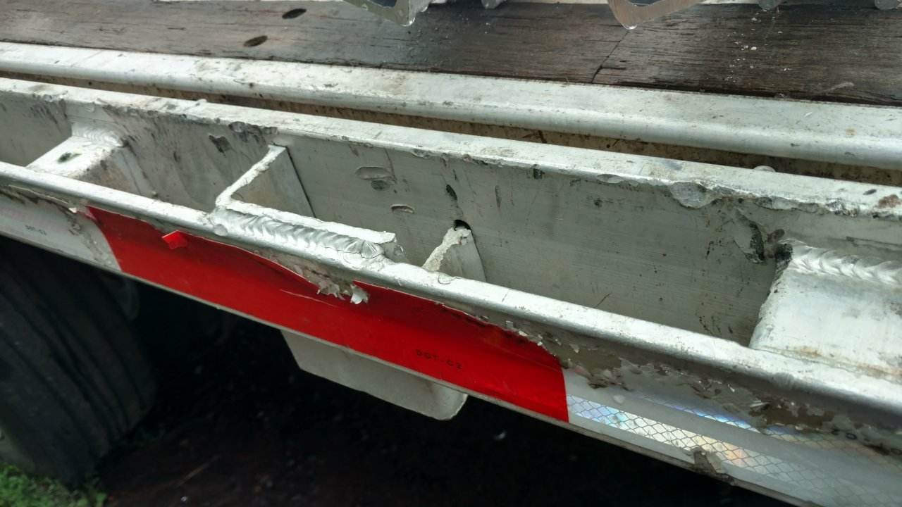

    Don't take this the wrong way.
    But a grunt in the field knows more about self preservation (IE getting the job done while covering his ***) than any general ever has.
    You've been using Company Policy and getting away with hooking to the aluminum pockets on that load king trailer. It looks like has a well built rail.
    You say you swap trailers all day. Never try that with a reitnouer. You'll be sorry.
    The genius engineer's decided to cut a slot in the rail and tack weld the pocket from the back side. Not even a full height slot. You can see it broke at the beginning of the weld.
    This is the 3rd grader welding job on the inside.
    This trailer got hit in the corner. I cleaned it up by knocking off the rest of the pockets with a 2# hammer. A HAMMER. tmp_6779-IMG_20160820_152212904_HDR1141924768.jpg
    An aluminum stake pocket is only good for hooking bungee cords in my opinion. Take a close look at the rear chain on your coil. Where it comes at an angle out of the pocket. I can guarantee you that 1/4" of aluminum will fail long before anything else. Then you've got nothing holding her back. Down in the bunks and forward, but not back.
    Again, I don't mean to bust your chops. The weights and weather you guys play in is more than most ever mess with, but Company Policy mentality only applies to steering wheel holders. The driver is the Captain of the ship at all times whether you own it or not.

    I appreciate the advice. I'm definitely going to be bringing this issue up at the next meeting, and from now on I'm going to be "captaining my ship" company policy be ###### at this point (your images were mighty illuminating, but we don't have any Retinouer trailers, fortunately), especially with coils.
    And I always try and use the posts where I can already. I've never liked the pockets. Round is always better than square in the world of strength (they don't make square submarines for a reason).
