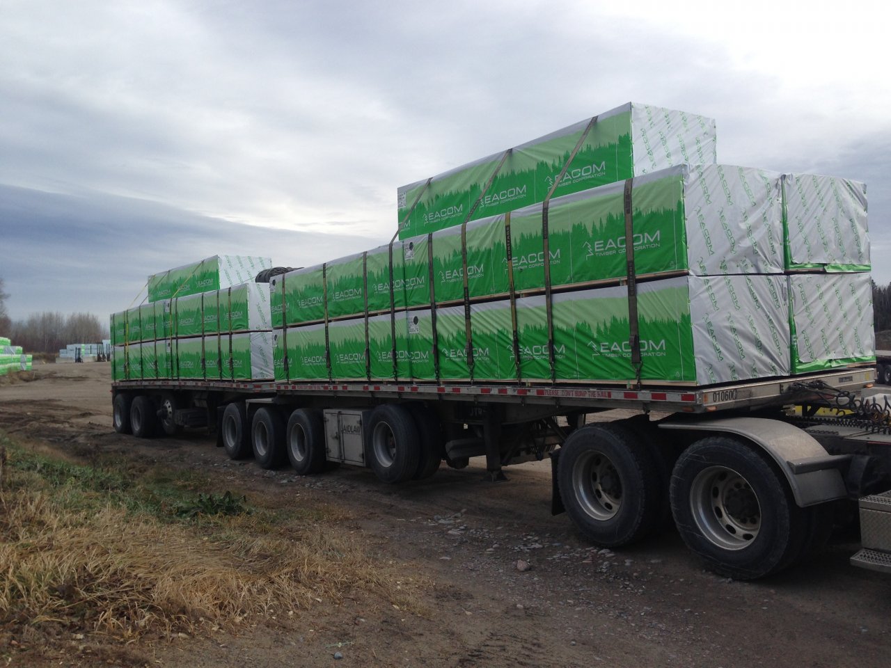

    IMG_20161117_063524038_HDR.jpg dropping at the port today in MD
