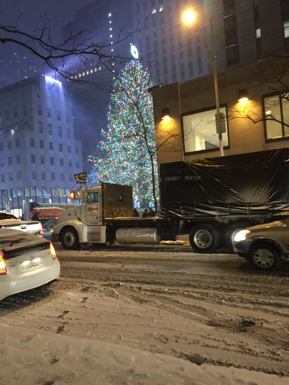

  4. Ruthless
    Ruthless Road Train Member
    8,948
    88,117
    Aug 28, 2010
    The City.

    Well,,,,your NYC pic is way better then mine the last time I was in the city.....
    Pouring down thunderstorm,trying to get a stretch load out at night.
    It was brutal.....

    I'd rather be long or fat than tall! Can't wiggle height much :0
    I have time for pics, bc my 6pm sharp appointment turned to 7 when I got here at 530..... Bet I'm not out of here for quite a few hours. Oh well. Charge them more.
