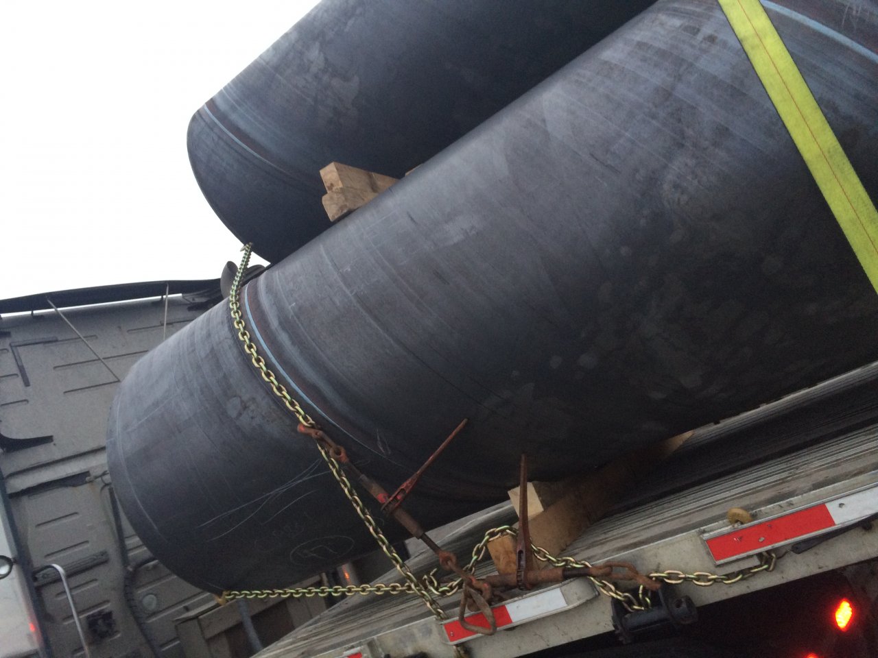

    Would look something like this except the top pipe on mine is smaller.
    Loader when I picked this up wanted to load like yours with 4x4 dunnage under the small pipe and I wouldn't let him. Probably would have been fine if I had hardwood but at the time I only had some cheap pine boards. The receiver complained but still unloaded it.

    I guess my rookie-ness is showing through today. I assumed if that's how they do it, it must work ok.
    I'm curious if I satisfied the 2 tie downs in the first 10 feet rule. If I had 4 chains at the ends, and one strap at the 9 foot mark, I think I'm ok?

    It probably does work fine most of the time. You may have gotten a board that already had a small crack and it wasn't strong enough. Like you said at least it happened while loading.
    I've never been a huge fan of having freight on boards that have a large gap under them. Too much of a chance that board could have small cracks and break while driving.
