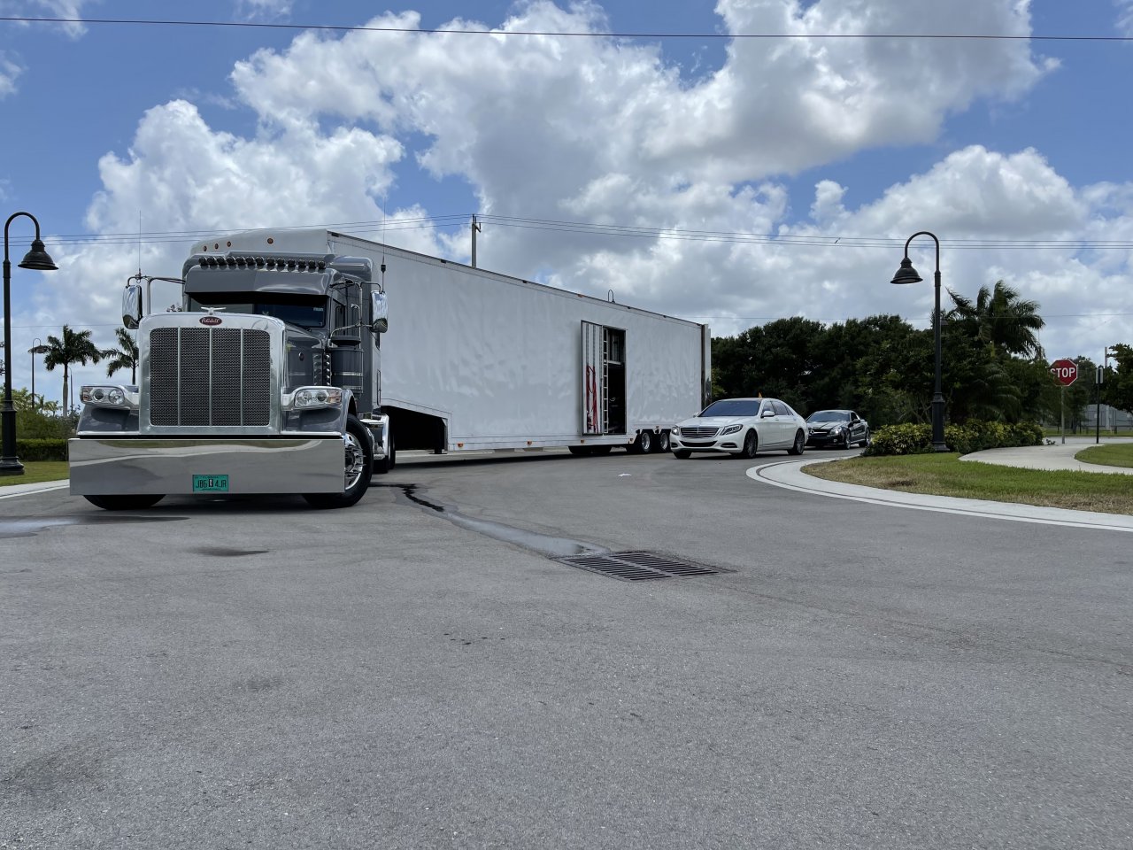

  8. Kawinige01
    Kawinige01 Heavy Load Member
    863
    1,150
    May 30, 2016
    South Fla

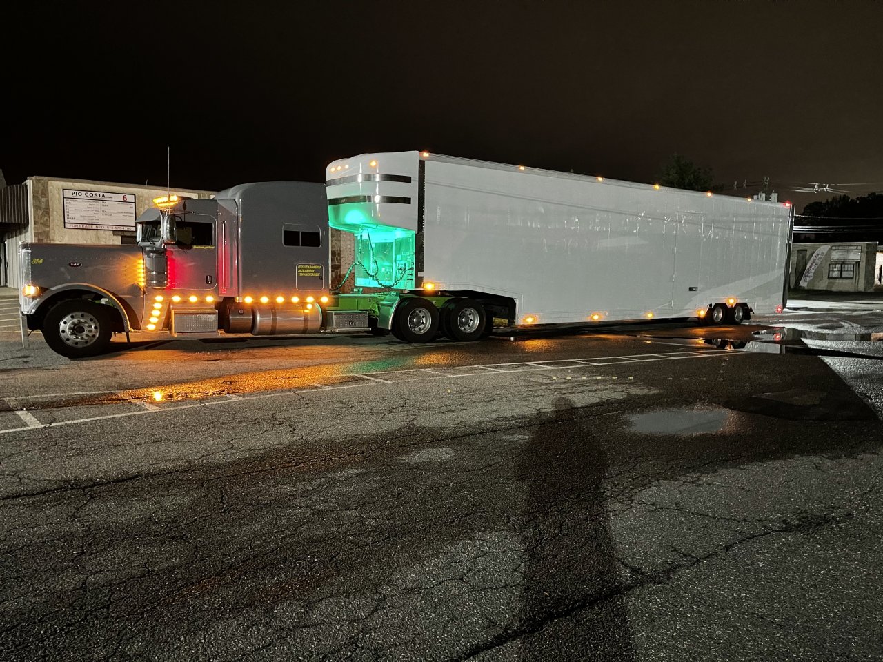

  9. Hammer166
    7,443
    26,939
    Aug 18, 2007
    ~8600+' and loving it!
    Rugerfan, sxdime, Tropsnart and 3 others Thank this.
  10. Kawinige01
    863
    1,150
    May 30, 2016
    South Fla
    BigBob410, Banker and Hammer166 Thank this.
  11. Hammer166
    7,443
    26,939
    Aug 18, 2007
    Thanks. My initial plan was for the diesel in the belly and the Yukon on #2, that would have balanced a touch better, I think. But both of them are wider than a 550, so that wasn't going to happen.
