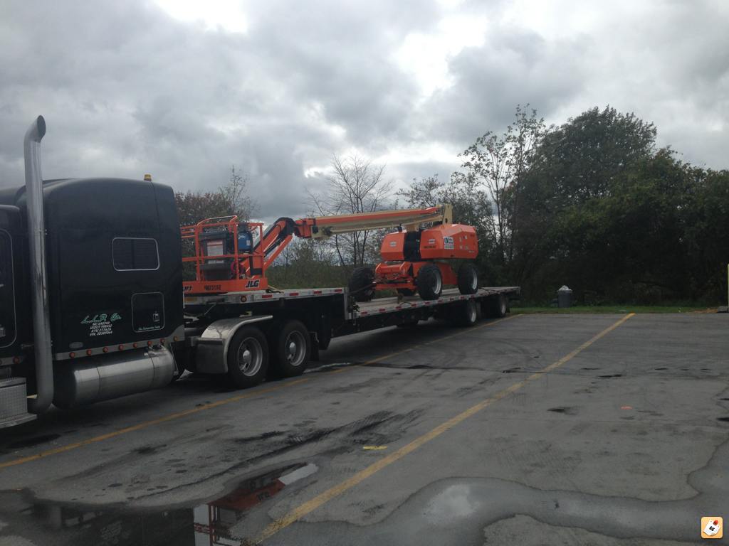

    Thanks for pointing that out. I hadn't considered it could be a problem, though I usually hook the chain back to itself as well.
    I think my reasoning at the time was that there wasn't much chain length between the lifting eye on the piece and the stake pocket to fit the binder in as well and I didn't want to go to a different pocket or spool because the angle would become very shallow and I like to keep chains short when they are at angles and low on the piece.
    I'm looking at it again now and think a better way would have been the run from one eye to around a spool and across to the other side and then the same thing there. Then the chain would have been straight across the deck and lined up with the eyes.
    But that would also have reduced the WLL.
