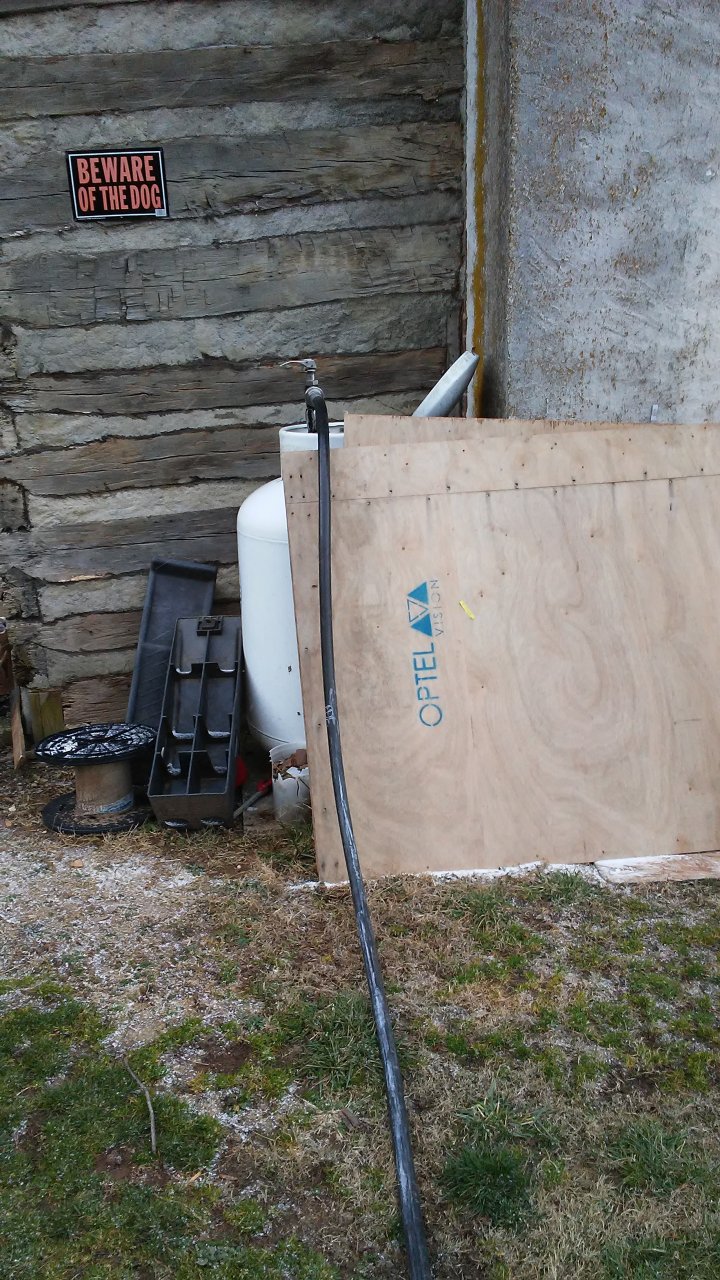

    Aug 15, 2016
    notice the 'beware of dog signs' especially when there is a fence, because once you open the fence gate to get in, most likely there is a dog running around somewhere in there. sometimes I leave the fence gate open just in case I have to make a run for it. can you say "who let the dogs out" woof woof. haha.
