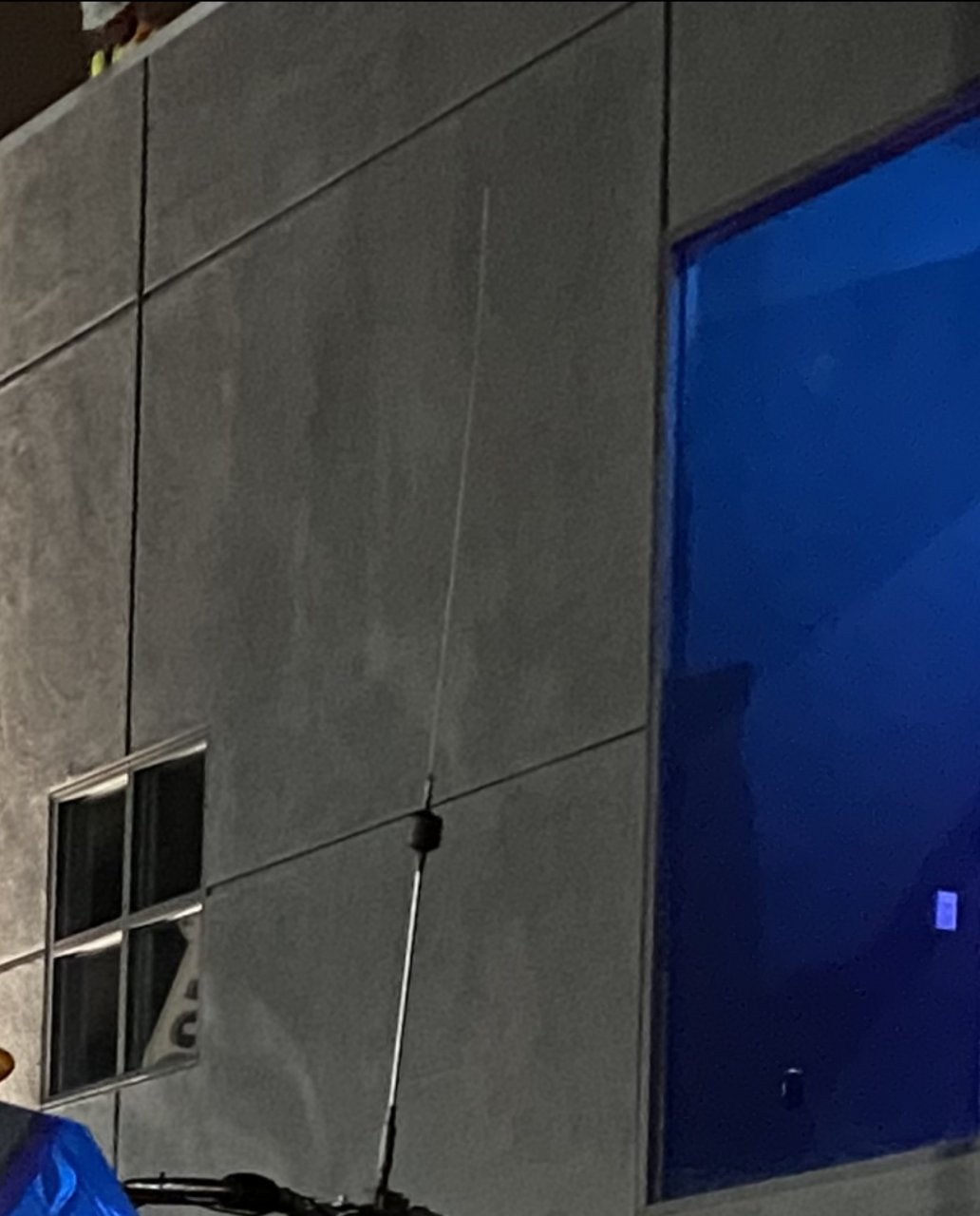

    I’ve learned through out my years of being into CB radio’s (1980’s) a single phase coil antenna has worked the best. And I make sure the stinger is high enough to clear and high loads and trailers, usually over 13’8” and 14’ from the ground. 8E72CBD9-6ADF-40C9-AF9D-875015E8DB0C.jpeg
  4. Mototom
    Mototom Road Train Member
    1,388
    2,703
    May 7, 2019
    How long is the shaft thats been added?
  5. Diesel Dave
    9,723
    33,225
    Jan 20, 2010
    Hesperia, Ca.
    18”.
