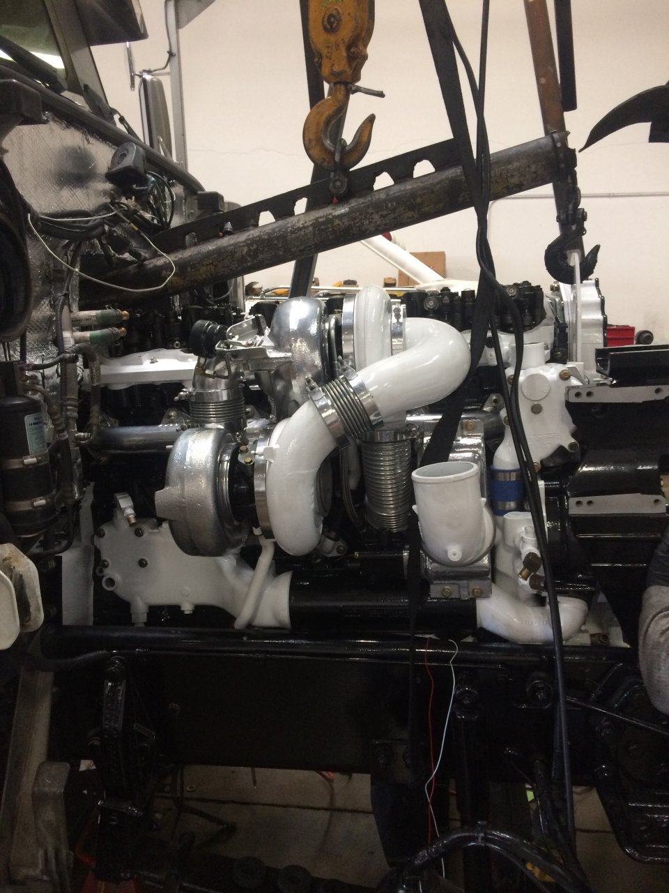

    The guidance from the FMCSA uses gliders as an example of trucks that have a pre 2000 engine installed. But it doesn't state that it has to be a glider. As long as it can be documented the the engine was manufactured pre 2000 you should be exempt.

    Sandra has a 2001 KW W900 with a transplant N14, engine was built in 98 so she thought she was safe... nope!! It's a recon engine from Cummins and they gave it a new birth date. Plus truck is older than 2000.
