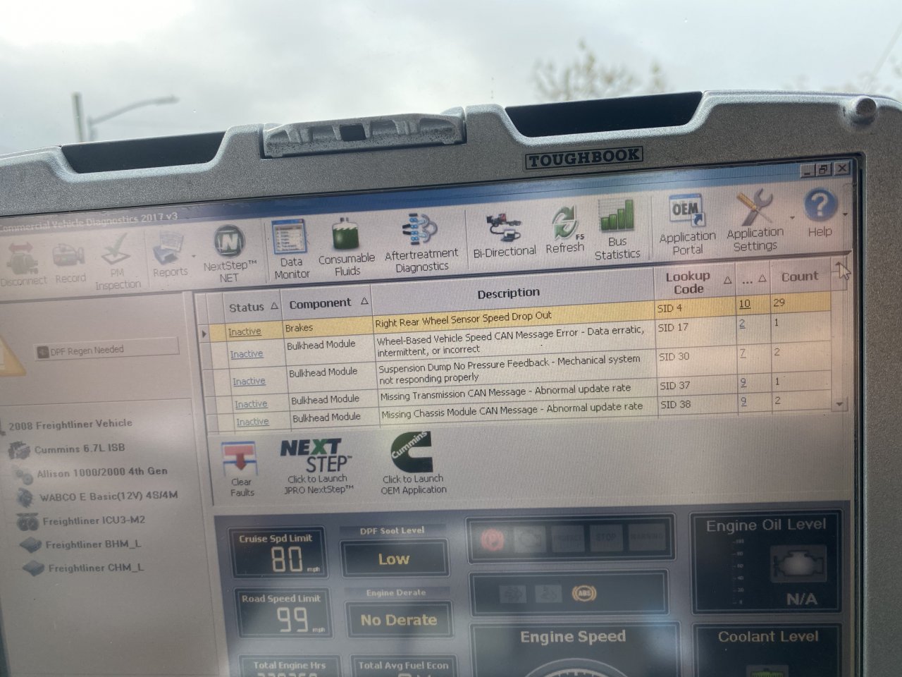

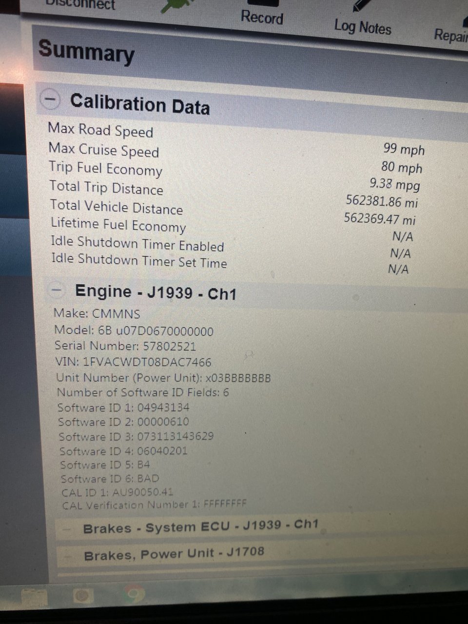

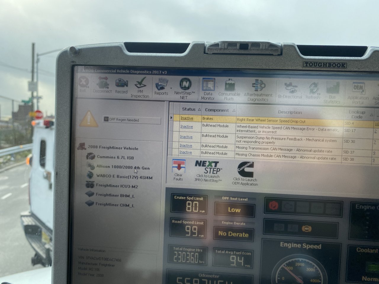

    These are pictures I took from the codes the computer was providing at the time. 6A1F620D-0C75-4F83-A96C-F021DD1721CF.jpeg B7581C21-03F9-43AC-81D2-21298F694AC0.jpeg B7581C21-03F9-43AC-81D2-21298F694AC0.jpeg

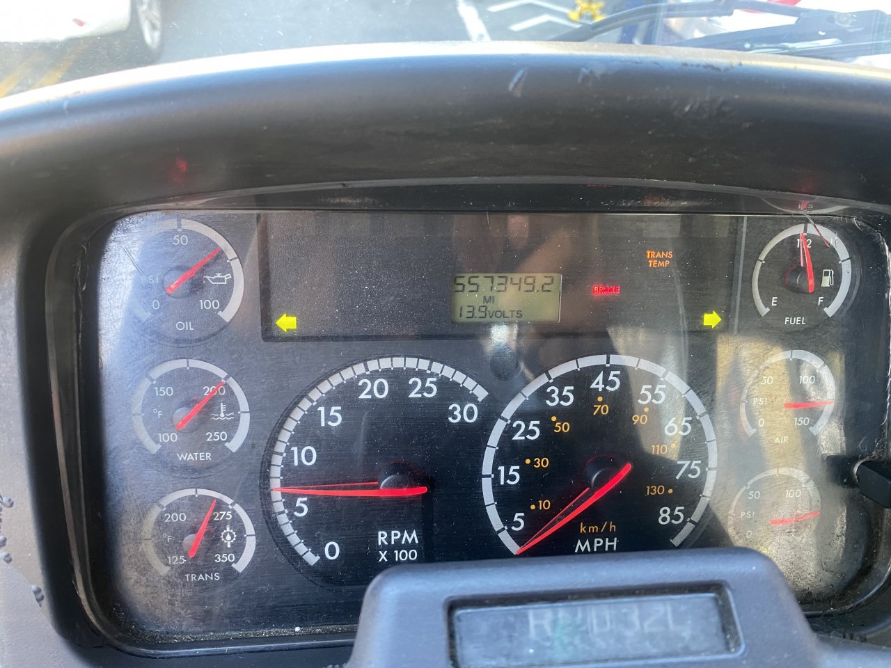

  6. Flint1
    Flint1 Road Train Member
    1,154
    9,880
    Sep 4, 2019
    Alberta
    I see you have that goofy column mounted shifter. They only used that for a few years. Maybe make sure you are actually in drive, and not in 4th...
  7. Hoffa
    Hoffa Bobtail Member
    16
    2
    Jun 5, 2021
    Yeah, I’ve checked that too. Unfortunately I’m going to go with a different axle and see how it goes from there. Thanks
  8. Roberts450
    Roberts450 Road Train Member
    2,237
    3,638
    Feb 6, 2016
    I dont see how the axle ratio is the problem when you've never changed it. You said before you changed the DPF it would go over 55mph but now that you've changed the DPF it wont. So somethings been changed electronically that is ether making the speedometer read slow or there is a speed limiter set somewhere in the system that you’re not seeing.
    AModelCat Thanks this.
  9. Hoffa
    16
    2
    Jun 5, 2021
    Yes, I’ve thought about that a lot but since I’ve been everywhere trying to figure this problem no one seem to get to the issue. I’ve spent some good money trying to get it right and nothing. I’m going to change all sensors on the dpf side and see if that helps. Unfortunately me relying on the “professionals” at Freightliner and Allison won’t get the job done but instead keep jumping hurdles. Thank you Robert. How would I go about looking into the speed limiter? I’ve looke all over for switches etc. And nothing catches my eye

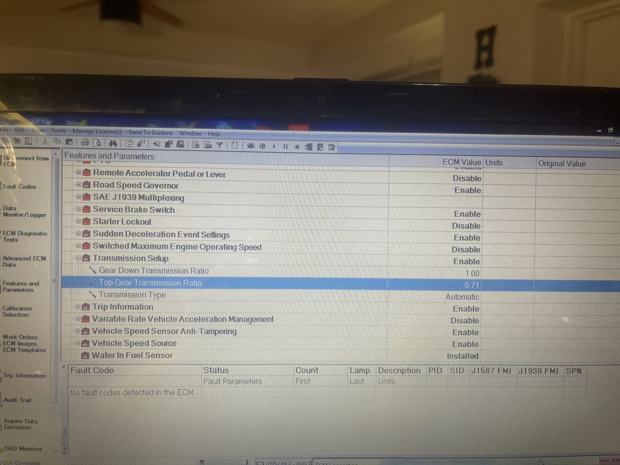

  10. Hoffa
    16
    2
    Jun 5, 2021
    Hi,
    Does this transmission gear ratio seems ok?
  11. Flint1
    1,154
    9,880
    Sep 4, 2019
    Alberta
    1.0 would be 4th in an allison 2500
    0.71 would be 5th
